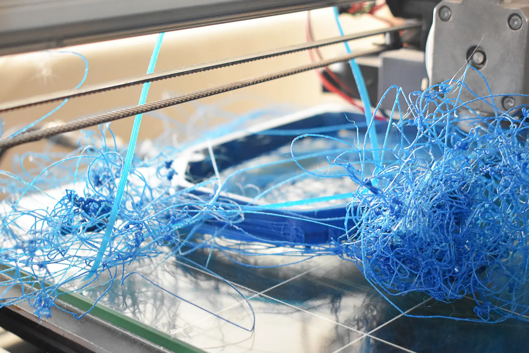

- Spaghetti. The model may become detached from the bed completely, but the filament will continue to extrude without any layers to attach to, causing the infamous pile of spaghetti.

My print looks like spaghetti. What did I do wrong?
Spaghetti failures happen when the nozzle keeps extruding filament after something has gone wrong with the print. The filament coming out of the nozzle has nothing to attach to, so it starts spewing into thin air.
- Check to see if your print has unsupported overhangs. If so, apply supports in your slicer software and try again.
- If the first layer has come off the build plate, go to our section on improper bed adhesion above to try to troubleshoot the cause.
- If the model is still attached to the build plate, that means something else went wrong. Look to see if any of your layers shifted or if your supports collapsed.
- If you find a gap in the model where filament stopped extruding, that could mean that you had an issue like a clogged nozzle.
Once you’ve pinpointed the problem, remove the failed print, correct the issue, and try again.
