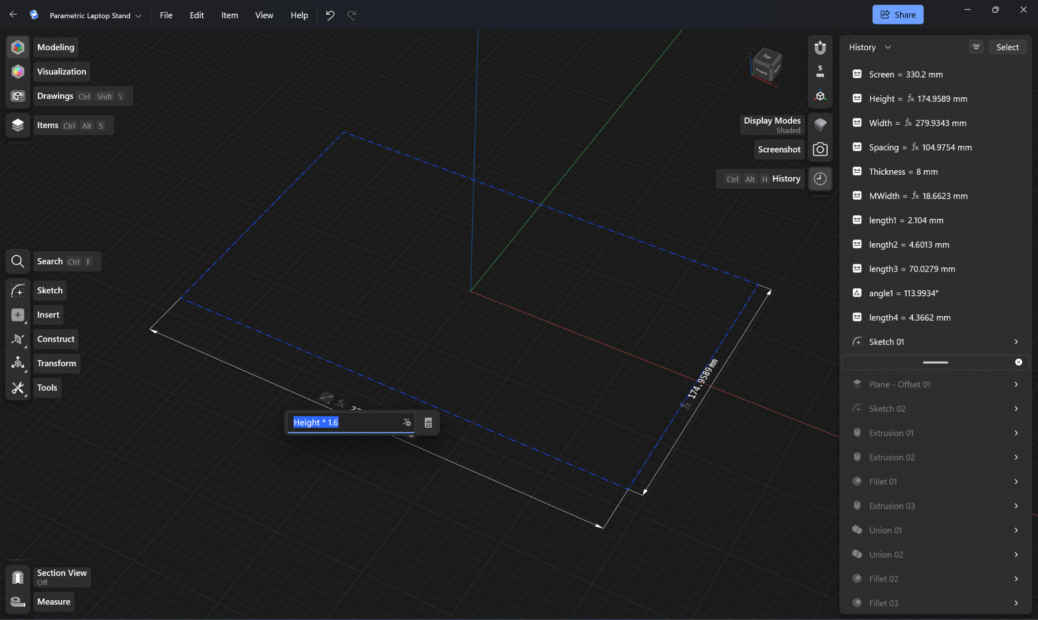

To make sure the riser works with different laptops, screen size (diagonal) was picked as the main driving parameter. All other dimensions, like overall width, height, and support spacing, were calculated from this one number.

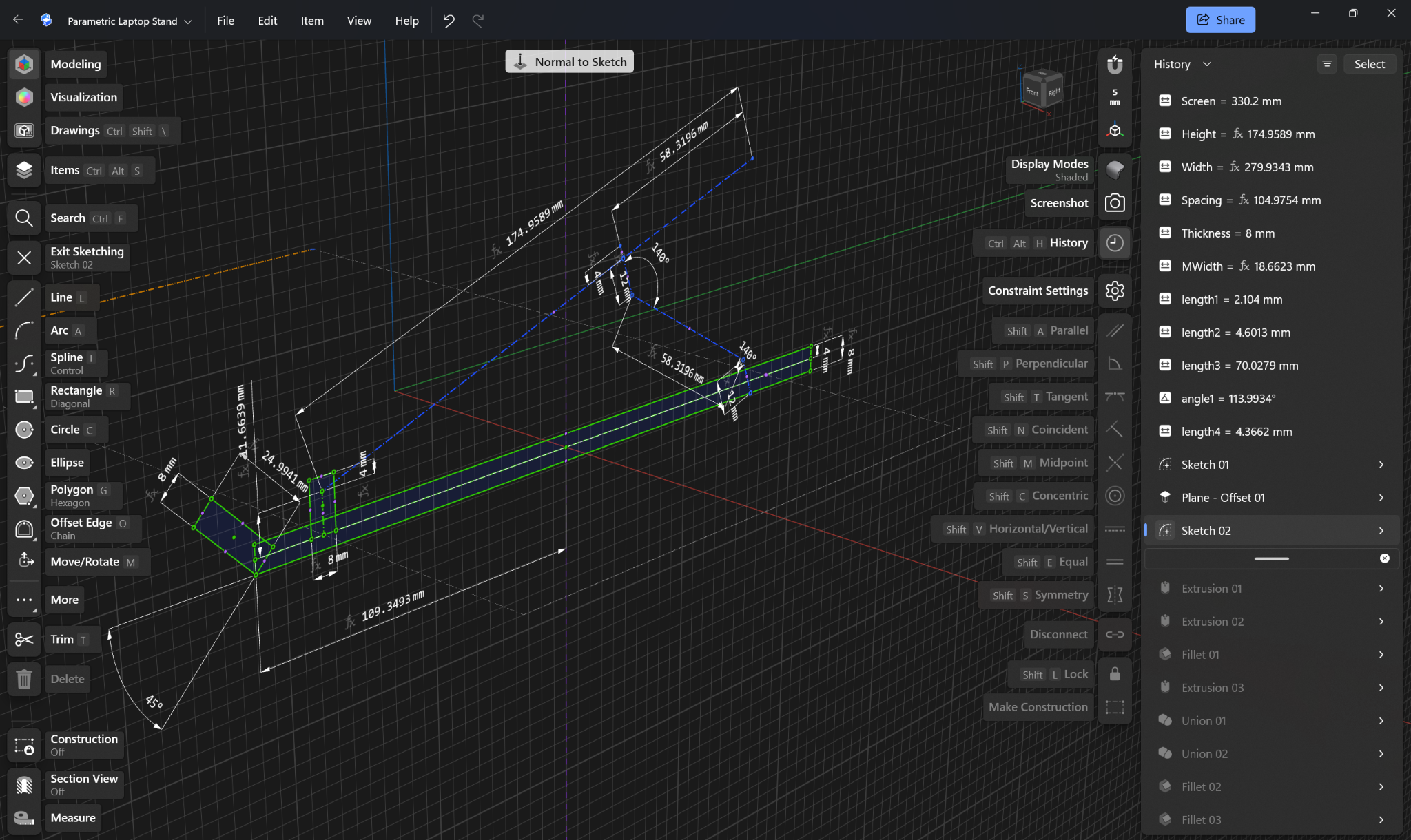

The foundation of the CAD model is a 2D reference sketch called a skeleton. This skeleton acts like a simple line drawing that controls all the 3D parts built on top of it. It includes three main parts: the display skeleton (Fig. 1), based on screen height; the adjusting mechanism skeleton (Fig. 2), which controls how the stand adjusts; and later the folding mechanism, which collapses the riser into a compact form for transport. Keeping this main sketch deliberately unconstrained in one direction let us test different tilt angles by simply dragging the lower point.
A side-profile skeleton was used to calculate the size of the main support arms. The base bars were designed from these dimensions. Their width, length, and thickness are linked to the screen height parameter, so when you change the screen size, the base bars update automatically (Fig. 3).

To design the adjustable bars, the side skeleton was used as a guide. By copying line geometry from the skeleton onto a new plane, we created the sketch for the adjustable bar. Linking it this way means any change to the main skeleton automatically updates the adjustable bars later. The 3D shape was made by simply extruding a rectangular profile (Fig. 4).
Fig. 4. Adjustable bars

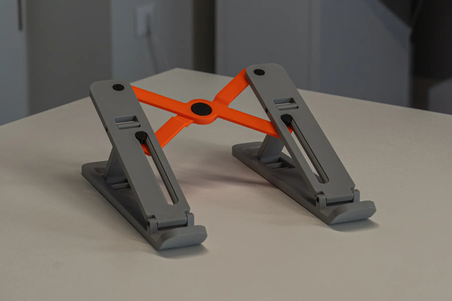

Once the first CAD model was done, we started 3D printing. We used a Bambu Lab printer and a Prusa Core One. The big structural pieces (base bars and adjustable bars) were printed on the Bambu Lab because of its larger print bed. The smaller pins were printed on the Prusa for better detail. Everything was first printed in PLA (Bambu Orange for the body, Prusa Marble Silver for the pins).
The first full print, with all parameters set to their defaults, went together fine. Testing, however, revealed a few real design problems that needed fixing.

The finished model and final print were tested and tuned for a 15-inch laptop. At this size, it easily holds slightly bigger laptops (like 16-inch models) and smaller ones too. While you can change the settings from 11-inch up to 20-inch laptops without breaking the sketch lines, printing and testing those extreme sizes is still a good idea to double-check their strength and fit.
