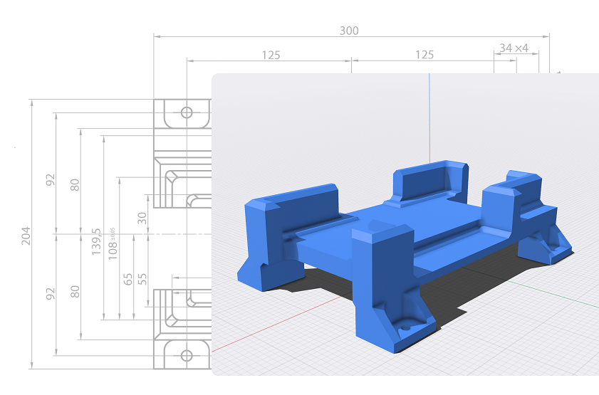

Jigs and fixtures are pivotal in creating a solid foundation for the overall manufacturing process in order to maximize productivity while ensuring worker safety and cutting costs. 3D printing as a form of additive manufacturing (AM) is a complementary method that can achieve these same aims with its implementation.
3D printing and effective jigs and fixtures manufacturing have overlapping aims which, when combined, directly complement each other.

When it comes to designing your jig or fixture you do need to be careful. As with traditional manufacturing methods, 3D printing also requires attention to get it right. We've outlined some best practices below, and we also recommend reading our full in-depth guide on how to design for 3D printing.
Prevent warping
To avoid part deformation, or warping, that can occur with sustained loading over time, make sure to close the build chamber.
Plan ahead for complexity
Building complex aspects of a part or including engravings in a model ahead of time can help to quickly produce the product needed. Many of these processes would require additional steps with traditional manufacturing but these can be minimized or eliminated when using additive manufacturing.
Testing
Adding geometrically accurate references, or a datum feature, directly into the build of jigs and fixtures helps to check their functionality and avoid errors in production. Performing consistent testing to check the reliability and performance of a prototype can reduce lead times for bringing the product to production.
