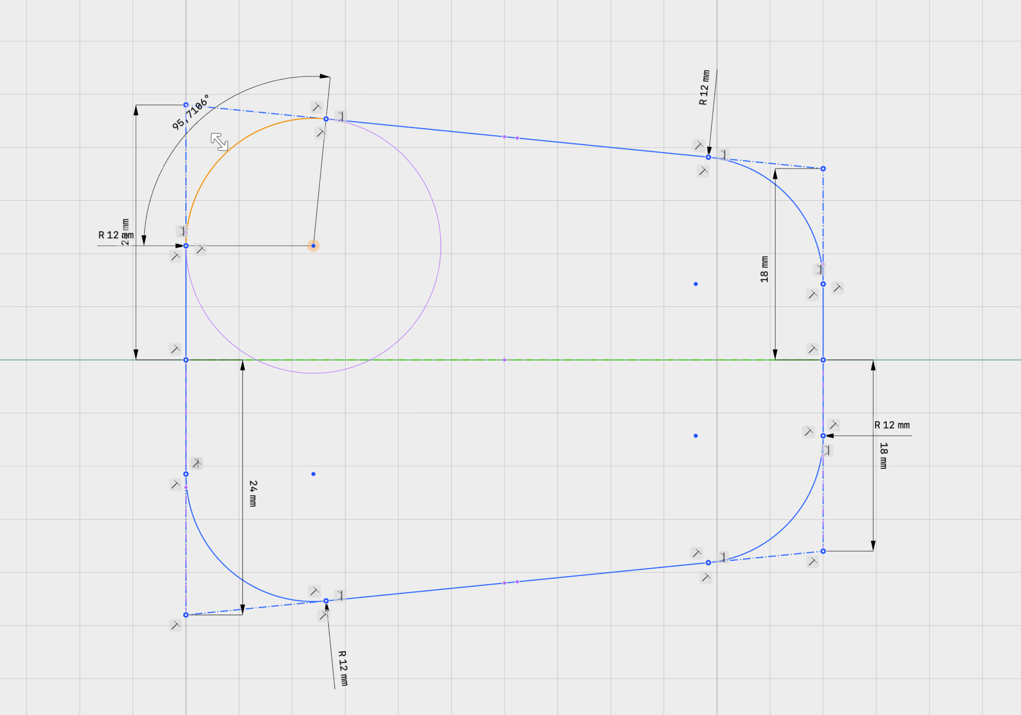

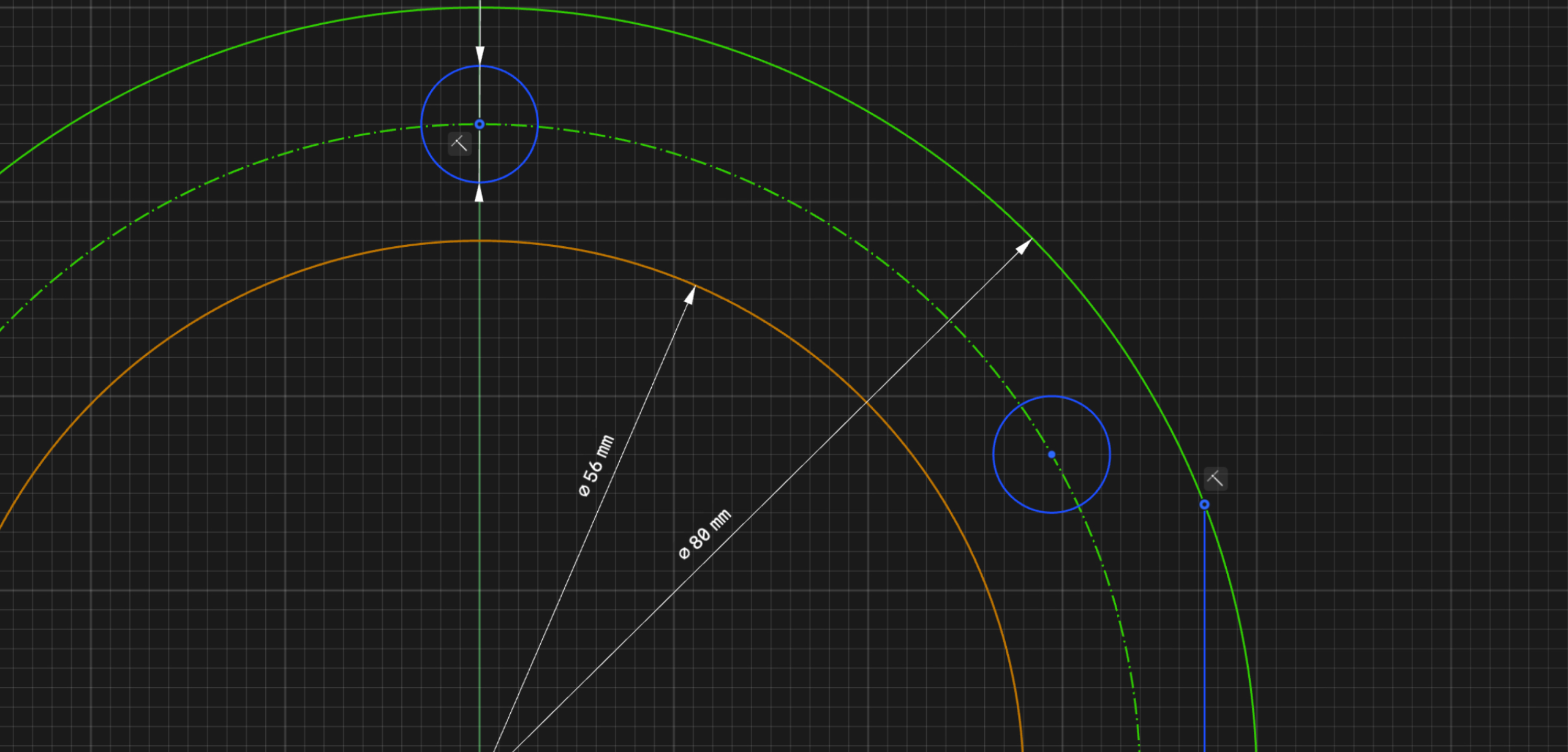

  • A sketch is under-defined if some of its parts can still be moved or resized. You’ll now find this displayed in blue.
  • A sketch is fully-defined if it has enough constraints applied to it so none if it can be moved or resized. Find this displayed in green.

From now on, instead of the previous teal sketch color, under-defined sketches will be displayed in blue, while fully defined sketches will be displayed in green.

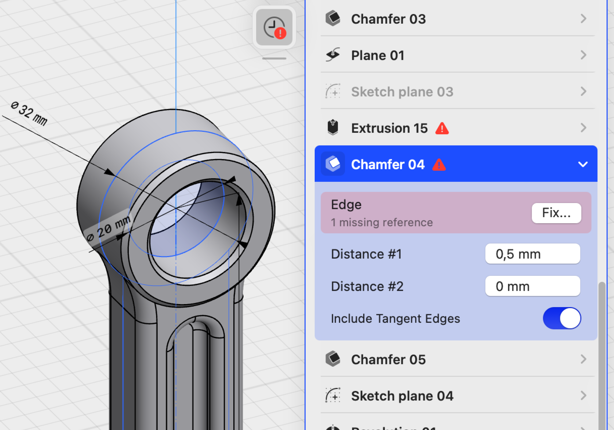

Error states in red
With the selection color modified to orange-yellow, everything that is error-related now shows up as red instead, such as missing topology references or erroneous steps in history.
