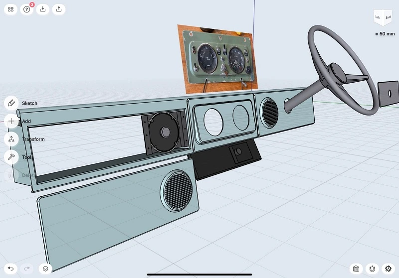

To solve design challenges, the team uses a combination of force and wit. Hammering things until they fall into place can at times become a necessity, but for parts that can be replaced, they’ve begun using Shapr3D as a concept design and CAD tool to create custom parts in the workshop.

Many of the models from the ‘60s and ‘70s don’t have working CAD files, so they work with a team that 3D scans the vehicle bodies, then import them into Shapr3D and work in the electric batteries and fixtures to show customers what the end result will look like.

Redesigning Land Rover dashboards

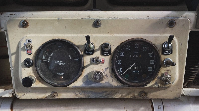

The dashboards on the really old pre-1970 Land Rovers were largely big hunks of metal with gauges and ignition in the center. The interior design itself is really simple, basically just the other side of the sheet metal exterior.
3D model of a Land Rover dashboard in Shapr3D
The design language of the car itself is strange, the way that the functions are described aren’t the most friendly. Many of the classic rigs don’t have symbols, just text, or unlabeled switches that drivers ‘know’ how to work.  Between the mystery handling and the novelty of electric vehicles, the team had to work hard to make the whole ride more approachable.

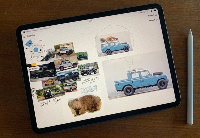

With this philosophy in mind, Dave goes into the Concepts app to create initial sketches and brainstorm. He likes the ability to compile references and look at things in a big picture way in the app. After some thoughts are sketched, he’ll move into Shapr3D.

In the dashboard, there were elements that were CNC milled out of thick aluminum stock while other elements were out of sheet metal. Dave exported those as models and pull them into Fusion. The thicker machine plate directly translated, but the sheet metal components he redraws in Fusion where the sheet metal tool is easy to use and he can export 2D drawings.
