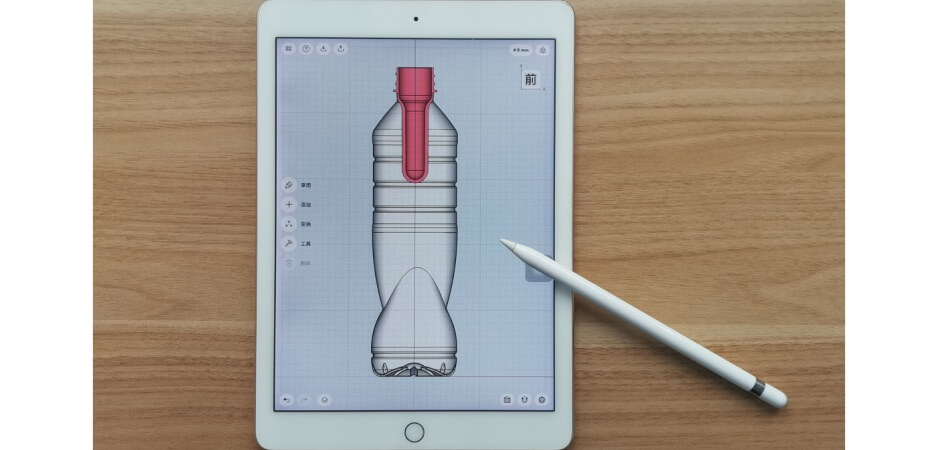

SIPA solutions bottle model in Shapr3D

During the initial conversation, Cheng is already at work, creating fast sketches on Shapr3D to show to the customer on the spot. Within an hour, he and the customer can go through several different designs, validating the direction and providing a base for strong concepts.
“What’s interesting is that the customer can take the iPad, touch the screen, rotate the bottles and see different views. Shapr3D is really very useful for client communication.”

A refined bottle design concept in Shapr3D
With legacy software, you can’t use an iPad to show different views. This can lead to confusion, the customer might not understand if the joint is straight, or what exactly it would look like if the design was modified in a particular way.
For Cheng, this often resulted in a time-consuming flurry of emails back and forth -- sending new views, implementing feedback, rinse and repeat. With Shapr3D the days-long feedback process boils down to hours, allowing the team to move from idea to prototype in record time.
