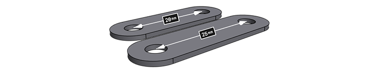

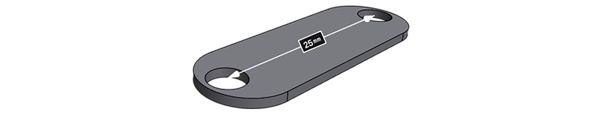

For example, let us say that you had a simple part with two holes. You wanted to change the distance between the two holes from 20mm to 25mm. Before PTC invented parametric modeling, you had to invest a lot of cumbersome and manual work to implement such a modification. Either you had to redesign the part from scratch, or you had to perform tricky Boolean operations or surface modeling operations to achieve the desired result. And this is a very simple example - just imagine how tedious it would be to change a more complex model.
A simple part with two holes and the measured distance displayed between them
Before parametric modeling, changing the distance between two holes was a tedious task

  • Unexpected changes. For instance, the previous part can be constructed in a way that changing the 20mm parameter to 25mm will result in the part below, and not the expected part above. Is the distance between the two holes 25mm? Yes. Is this what we wanted? Of course not. Why is it broken, then? Well, in this simple case, we could relatively easily find the error, but good luck debugging similar issues with parts that have 1000+ features.
A simple part with two holes and the measured distance of 25 mms between them
Getting the result you want can be tough with parametric modeling

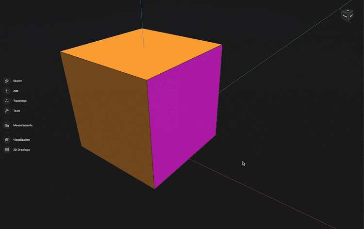

Easier said than done, right? Let us take a very basic example: moving a face of a cube. In this video, we are moving the purple face in the direction of its normal vector. As you can see, the surrounding orange faces are being extended and shrunk as we move the blue face.
A cube's face is being pushed and pulled to adjust it's shape
Face Move let's you adjust a basic model with ease

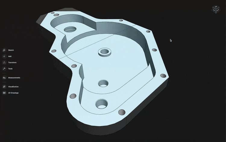

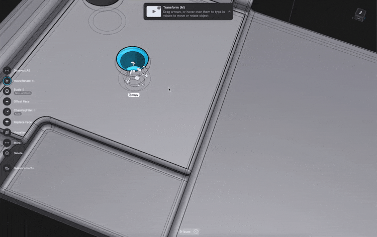

Now that we understand the basics, let us take a look at a real life demonstration. In the example below, we received an iPhone fixture model. It arrived in a neutral CAD format, like X_T or STEP, and imported it to our favorite CAD system, so we don’t have the parametric history of the model. However it turns out that, for some reason, we need to move a hole by 1cm. Without modern Direct Modeling, we’d need to either completely remodel the entire part, or do some cumbersome CAD magic to achieve what we want. However, with modern Direct Modeling, we can easily move the hole 1cm in the desired direction.
A hole on a fixture model is getting pulled around
A moment for Direct Modeling to shine: moving a hole is done in seconds
While this operation is seemingly more complex than the previous ones, the exact same algorithm is performing very similar operations under the hood. First, it detaches all the faces that we are moving, then it moves the surfaces into place, then it extends or trims the surrounding surfaces guaranteeing that we end up with a watertight, manufacturable solid body.

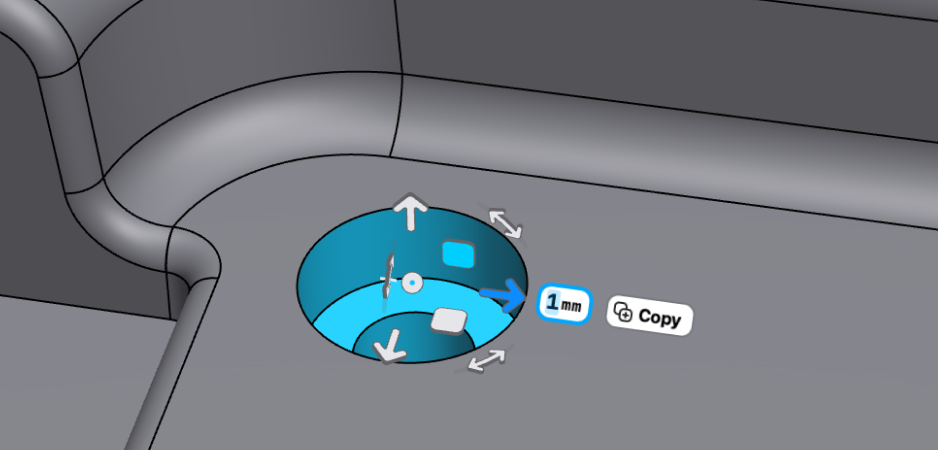

Offset Face is very similar to Face Move, with the main difference being that the surface of the face is replaced with an offset surface. In the example below, we are applying the Offset Face operation on two holes, changing their diameters.
A fixture model's hole is being modified by using Offset Face
Offset Face also lets you tweak the diameter of a hole
