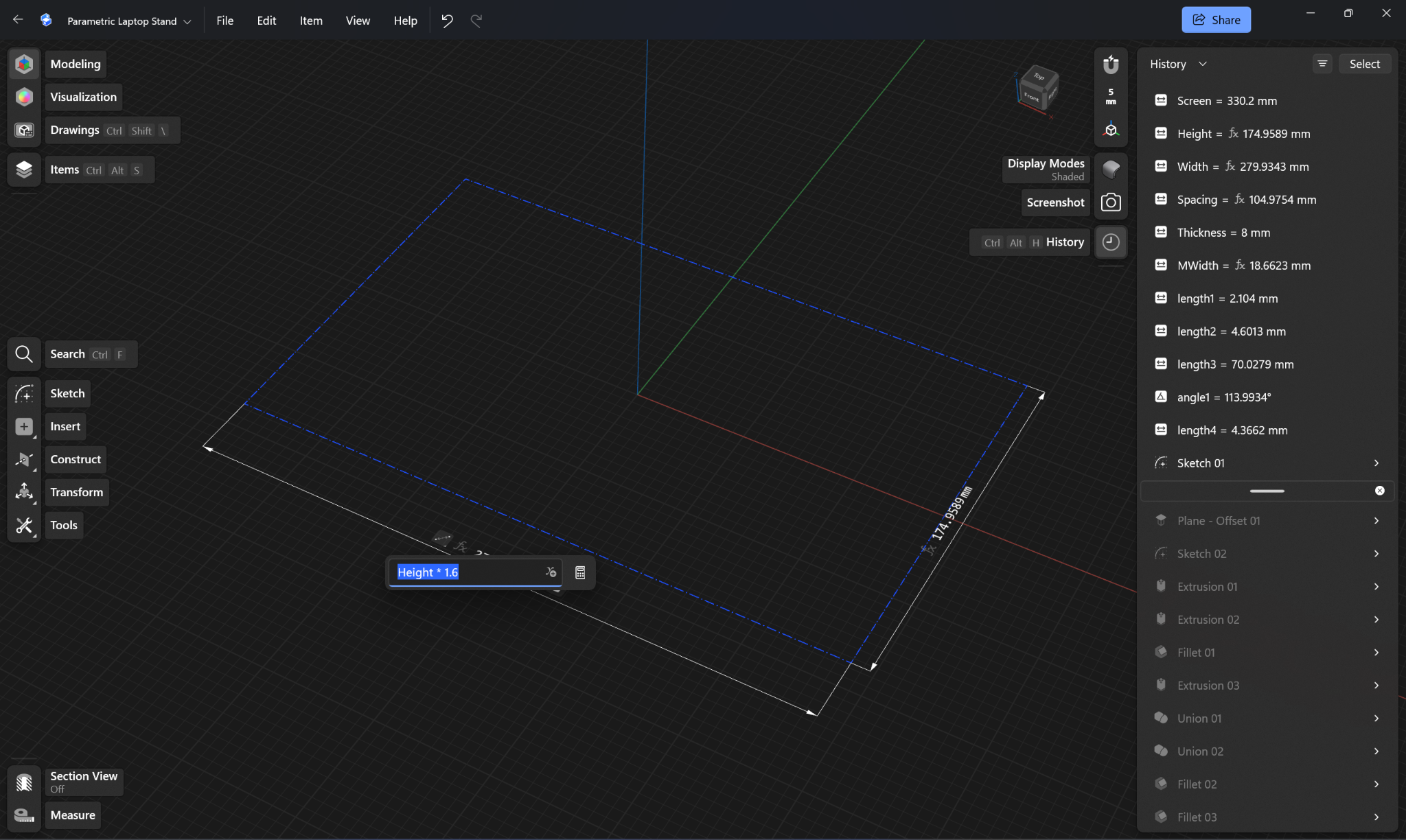

Before modeling any part for 3D printing, it pays to plan ahead. Because this model is parametric, deciding on the main driving numbers and how different parts relate to each other was crucial from the very beginning. Even if the initial plan changes, parametric design lets you make changes easily. Shapr3D is great for this: using the design history, we could step back in time, change basic sizes, and automatically update later steps without breaking the model.
The design process started with researching existing laptop risers and checking them against the realities of 3D printing. We looked at real limits like print bed size, minimum detail size, overhangs, material shrinkage, and print orientation for a high-quality surface.
To make sure the riser works with different laptops, screen size (diagonal) was picked as the main driving parameter. All other dimensions, like overall width, height, and support spacing, were calculated from this one number.

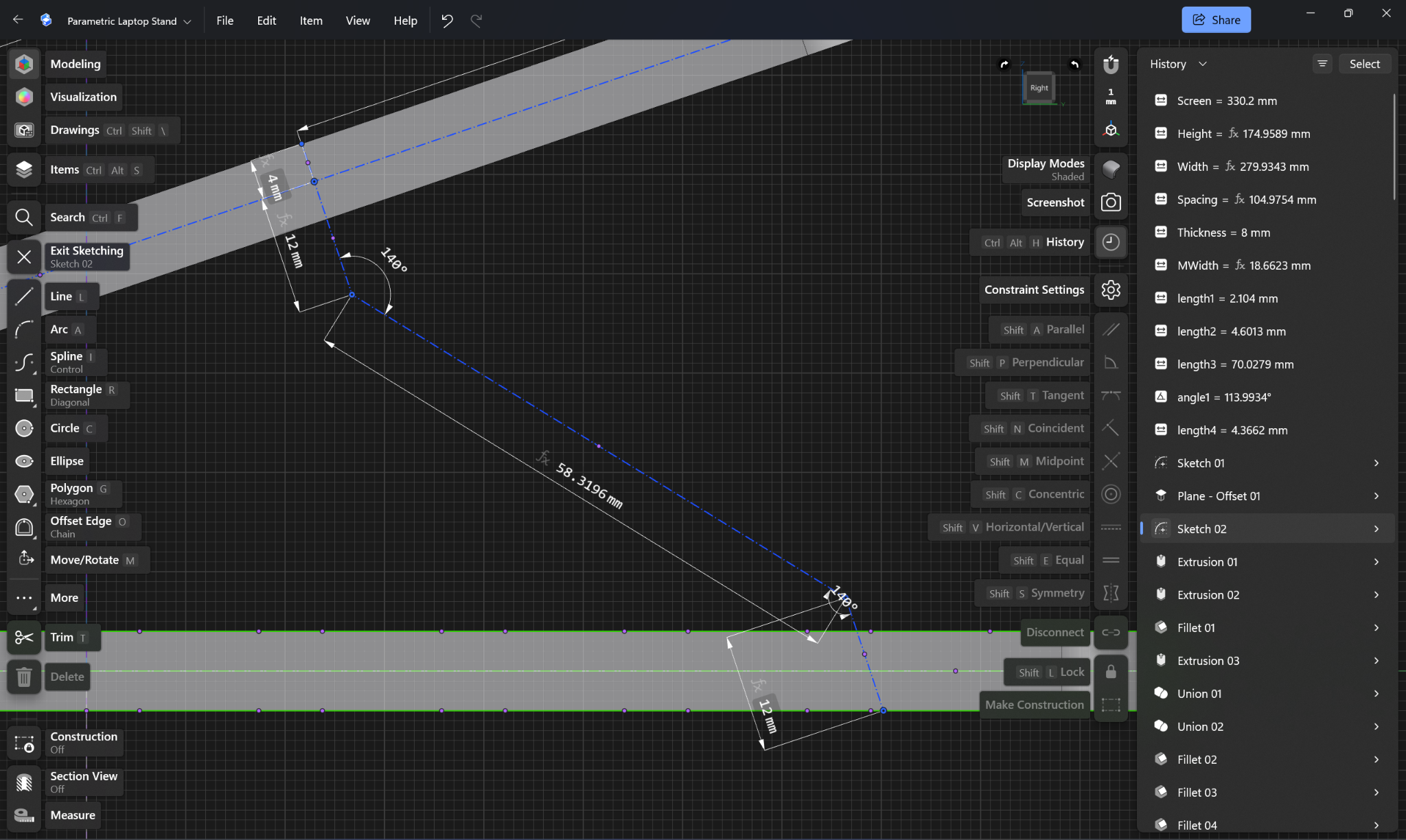

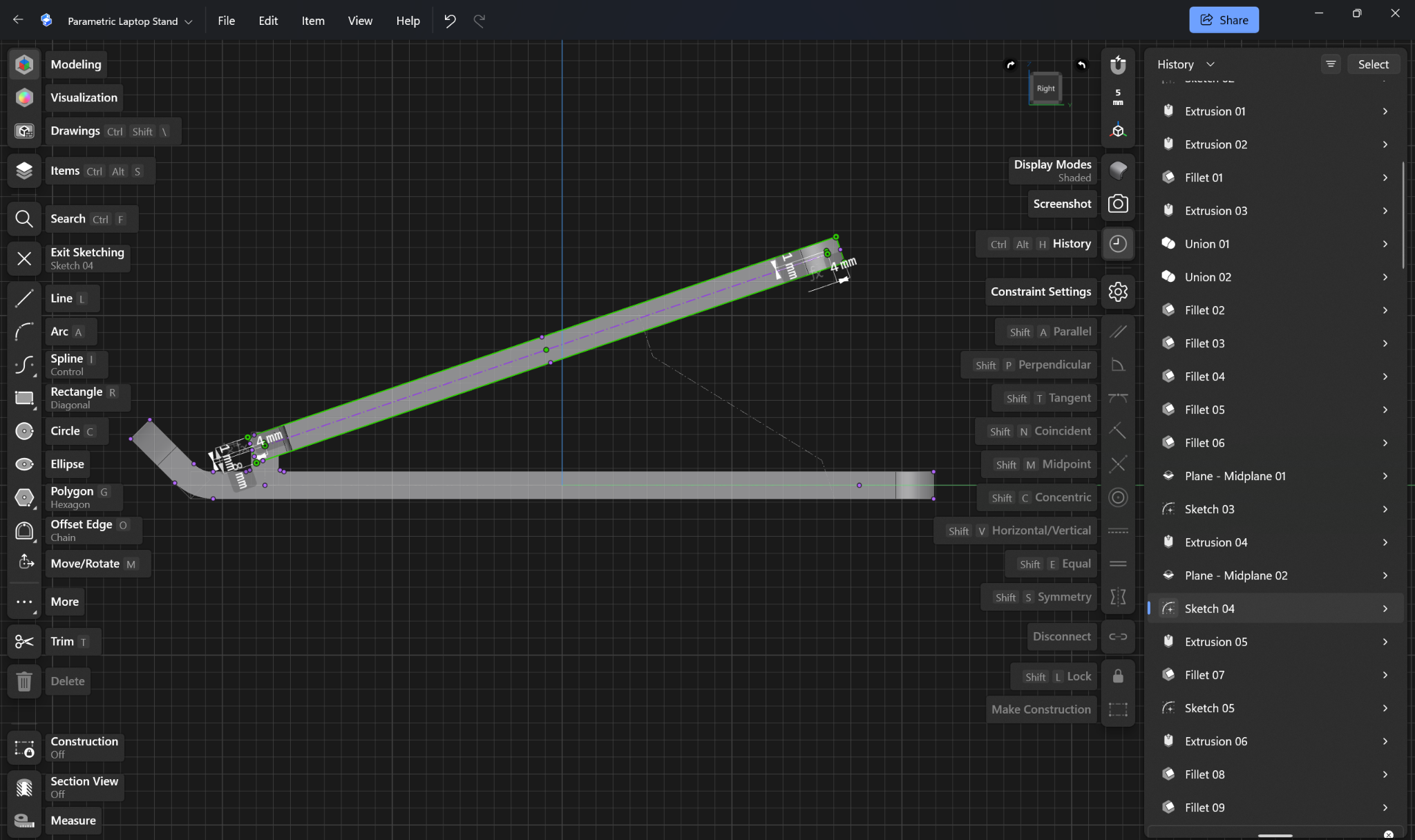

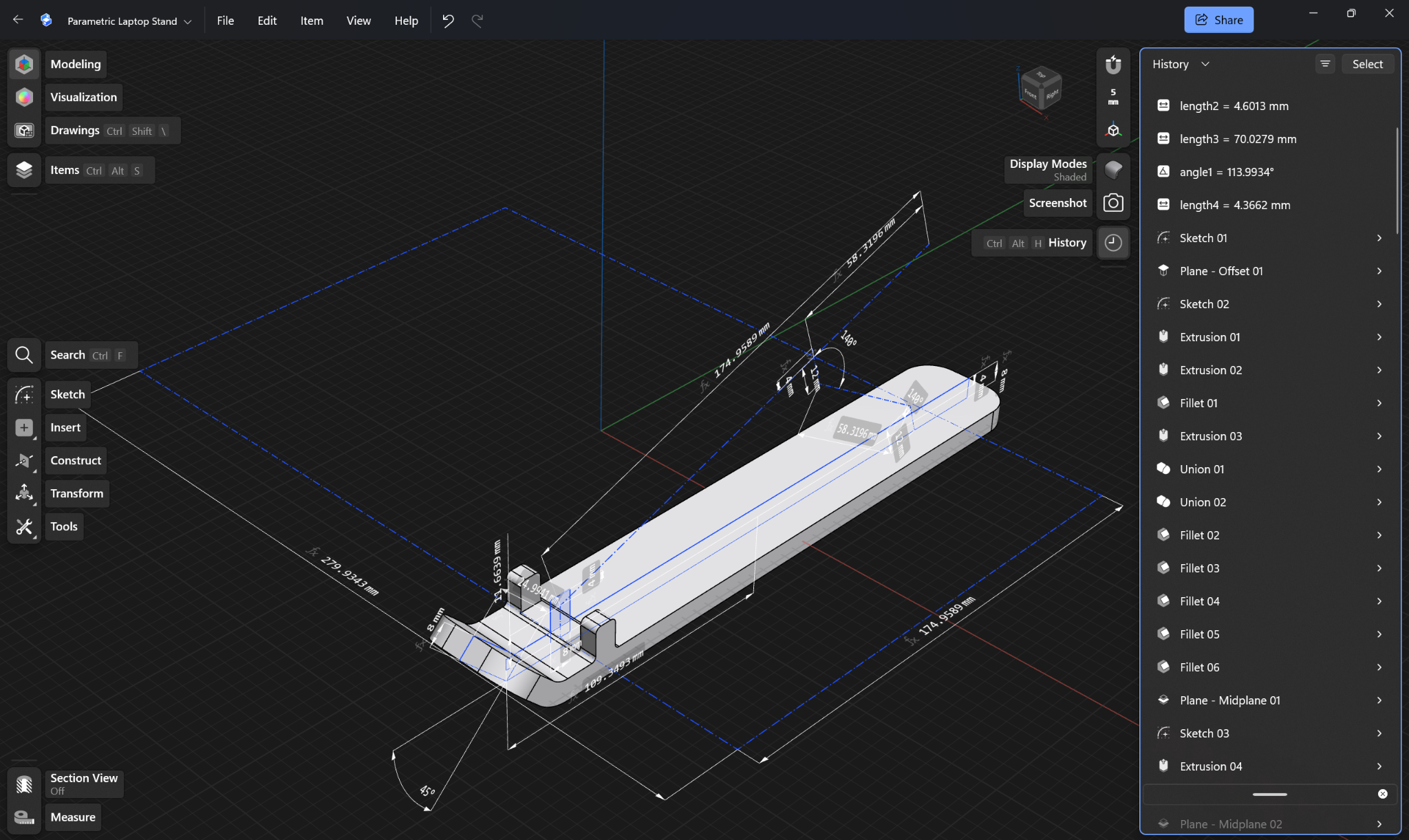

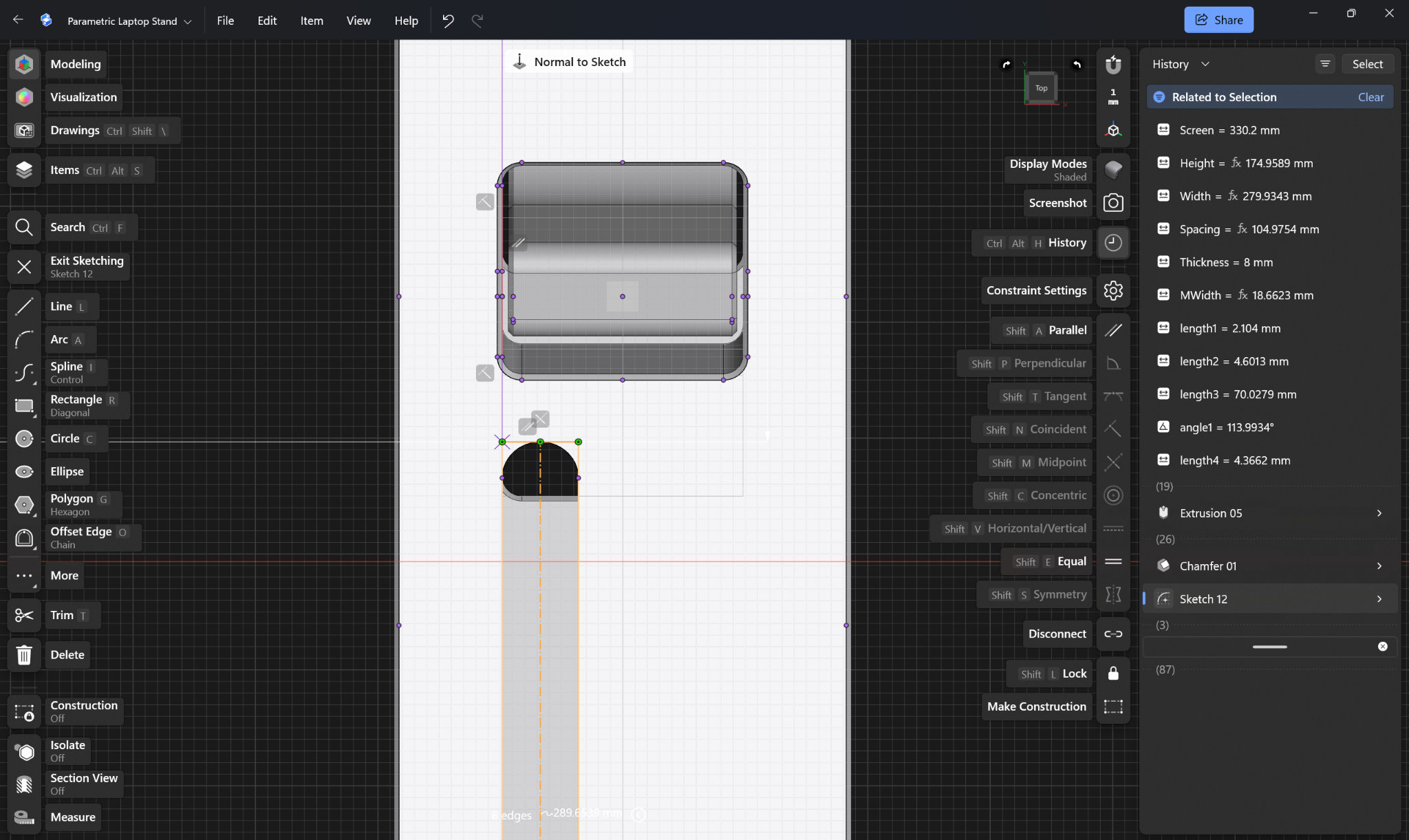

Skeleton model & base geometry
The foundation of the CAD model is a 2D reference sketch called a skeleton. This skeleton acts like a simple line drawing that controls all the 3D parts built on top of it.
Fig. 1. Display skeleton
It includes three main parts: the display skeleton (Fig. 1), based on screen height; the adjusting mechanism skeleton (Fig. 2), which controls how the stand adjusts; and later the folding mechanism, which collapses the riser into a compact form for transport. Keeping this main sketch deliberately unconstrained in one direction let us test different tilt angles by simply dragging the lower point.
Fig. 2. Adjusting mechanism skeleton

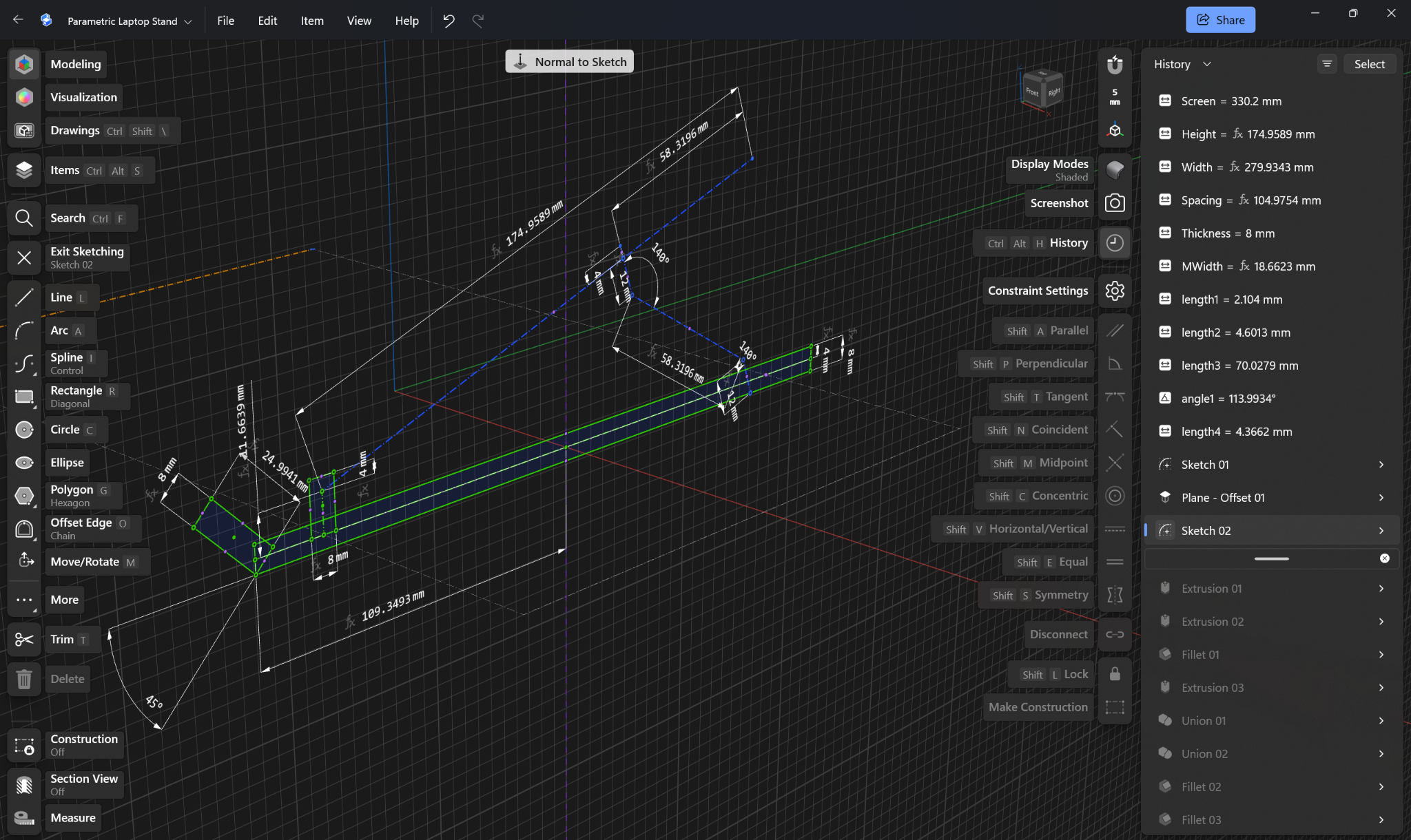

A side-profile skeleton was used to calculate the size of the main support arms. The base bars were designed from these dimensions. Their width, length, and thickness are linked to the screen height parameter, so when you change the screen size, the base bars update automatically (Fig. 3.).
Fig. 3. Base bar

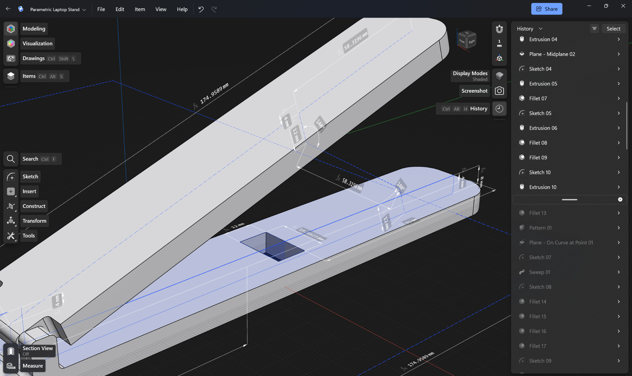

Adjustable bars & position notches
To design the adjustable bars, the side skeleton was used as a guide. By copying line geometry from the skeleton onto a new plane, we created the sketch for the adjustable bar. Linking it this way means any change to the main skeleton automatically updates the adjustable bars later. The 3D shape was made by simply extruding a rectangular profile (Fig. 4.).
Fig. 4. Adjustable bars

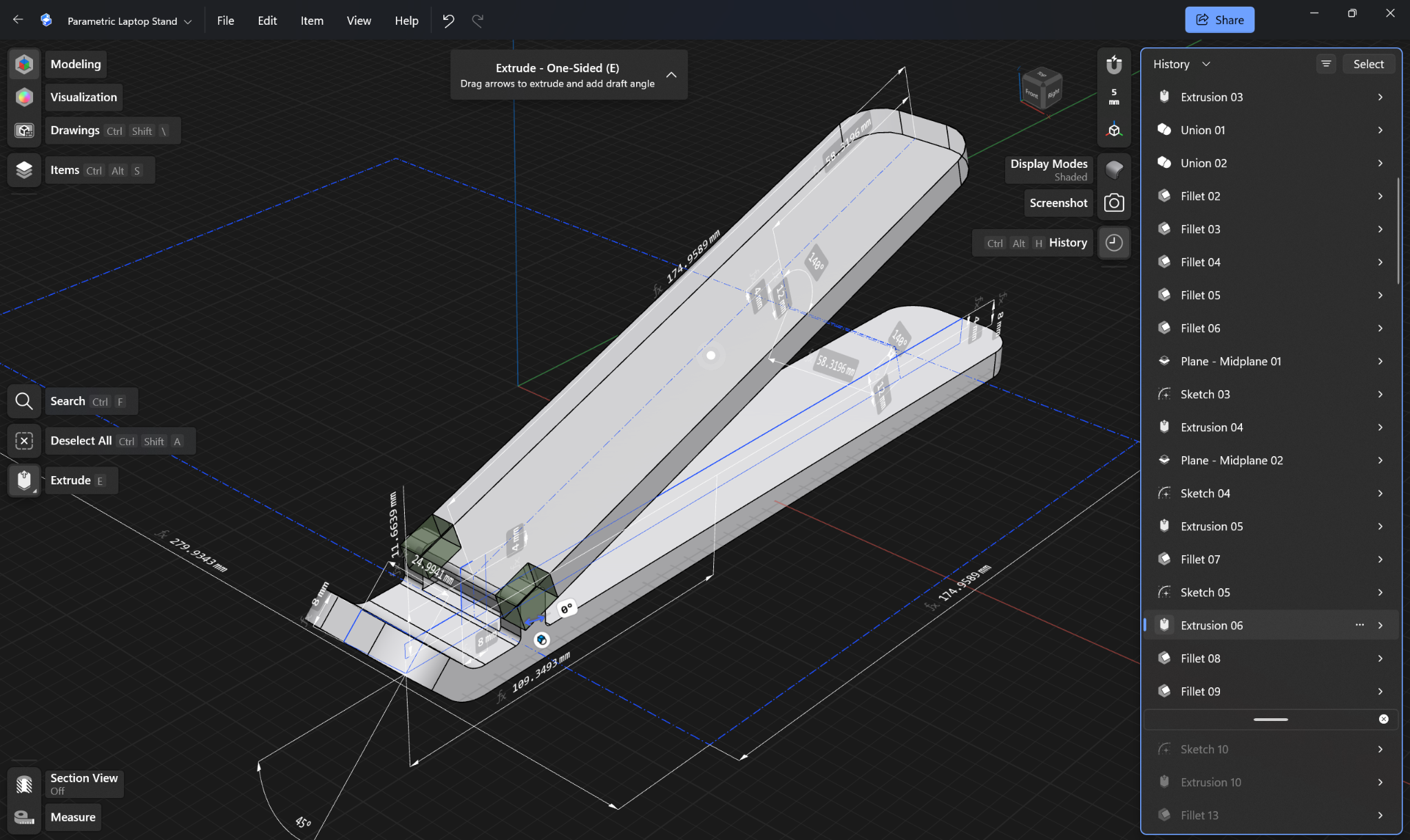

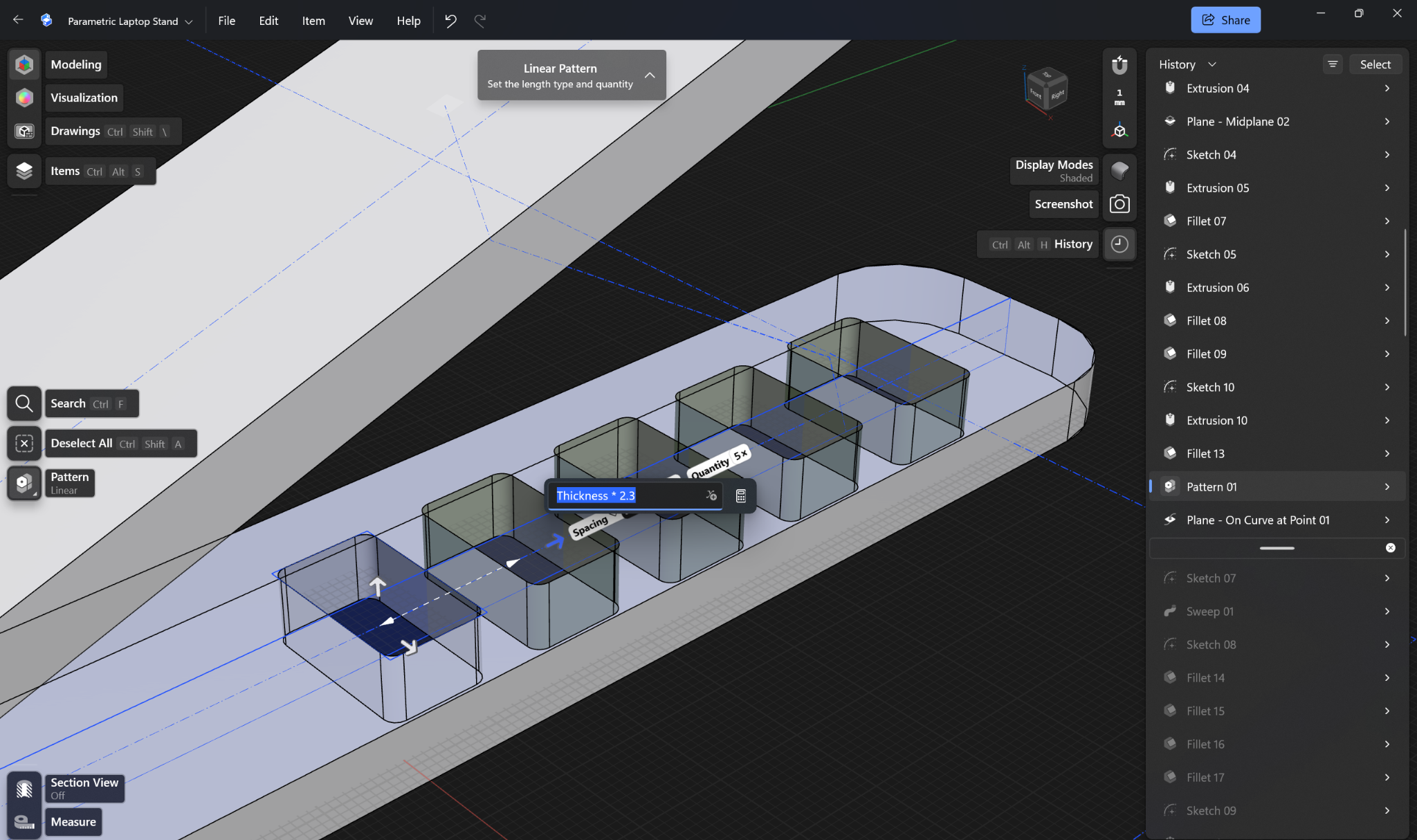

Next, the height adjustment notches (the slots used to set the laptop angle) were cut into the bars using simple extrusions (Fig. 5.). The notch sizes depend on material thickness and screen height: thickness sets the depth along the bar, while screen height sets the width across it. A pattern tool was used to copy the notches down the bar, with spacing based on the screen height (Fig. 6.).
Fig. 5. Single notch created with Extrude cut
Fig. 6. Notches created with Pattern

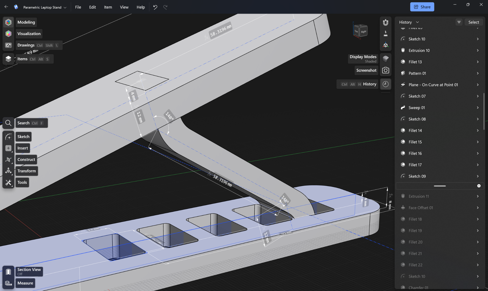

The vertical supports connect the base bars and the adjustable bars, locking the riser at different angles. These supports have a custom curved shape made with the Sweep tool. The skeleton was used as the path to follow (Fig. 7.), and the cross-section shape was drawn right on top of the adjustable bar. We rounded the corners with fillets to make them stronger and offset the sketch lines slightly to make sure the hole sizes were right (Fig. 8.).
Fig. 7. Vertical support path sketched for Sweep
Fig. 8. Strong corners made with Fillets

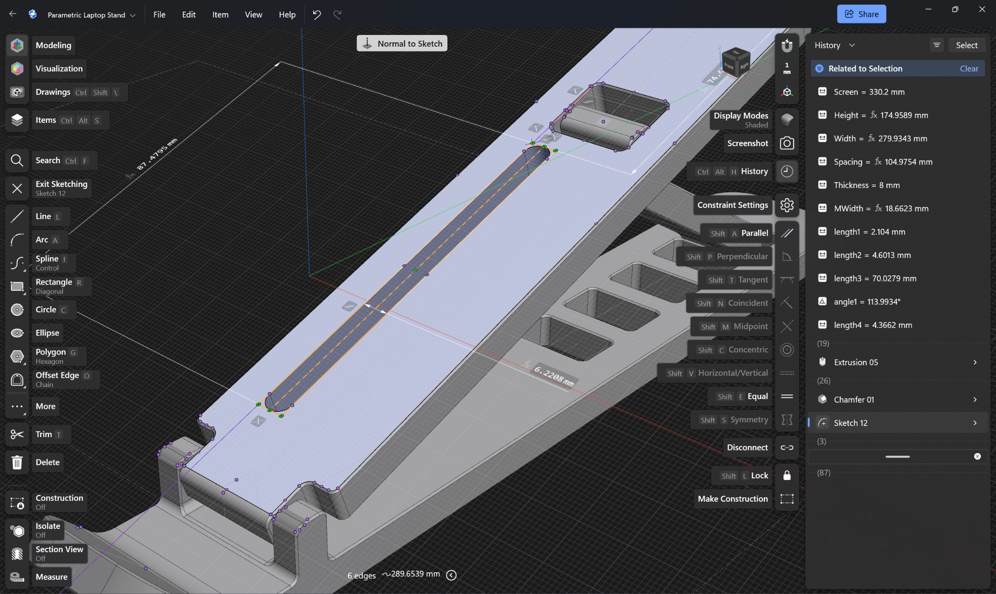

A key feature on the adjustable bar is the sliding slot (Fig. 9.), which guides the folding mechanism as it opens and closes. The slot length sets how far the folding arms move, and its position makes sure the folding arms don't hit the vertical supports when collapsed. The slot was placed right in line with the hole for the vertical support (Fig. 10.). To stop the sliding pins from sticking out and scratching the laptop, an indentation was added so the pin head sits flat and flush.
Fig. 9. Sliding slot
Fig. 10. Sliding slot aligned with vertical support

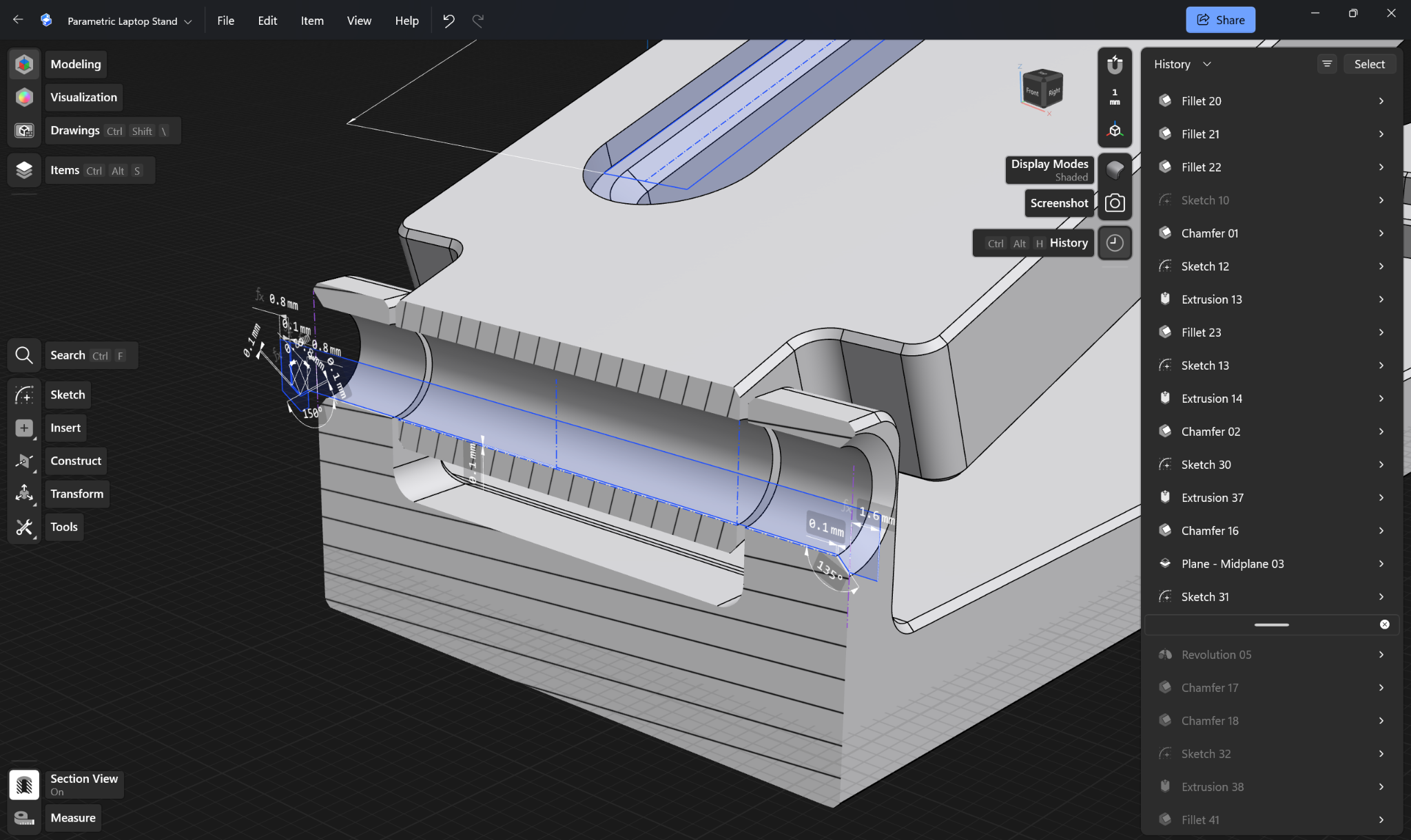

Holes were added at the main pivot points and where the vertical supports attach (Fig. 11.). The size of every hole is tied directly to the material thickness setting. If you change the part thickness, the holes scale automatically so the walls stay strong. We used the same hole size expression across all joint points, so the same pins work everywhere.
Fig. 11. Pivot point
Instead of printing the joints already connected in one piece (print-in-place), which can't be taken apart or repaired, we made separate snap-fit pins. The pin sketches were made directly inside the holes, so if a hole size or part thickness changes, the pin size changes with it. We then copied and moved the pin into all the other holes using the Align tool. (Fig. 12.)
Fig. 12. Pin sketch drawn in reference to context

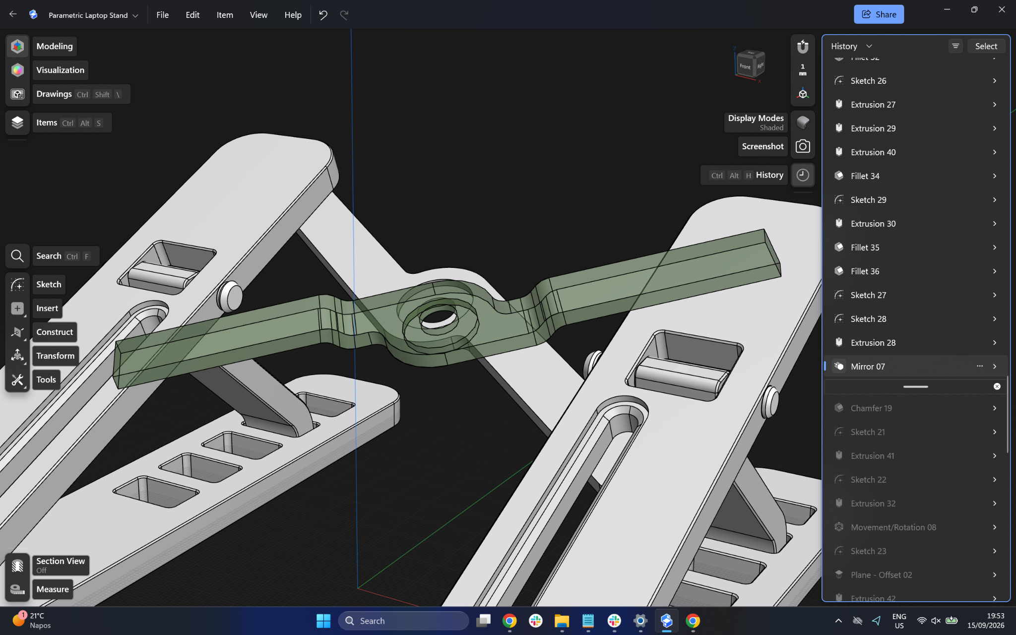

Scissor folding mechanism design

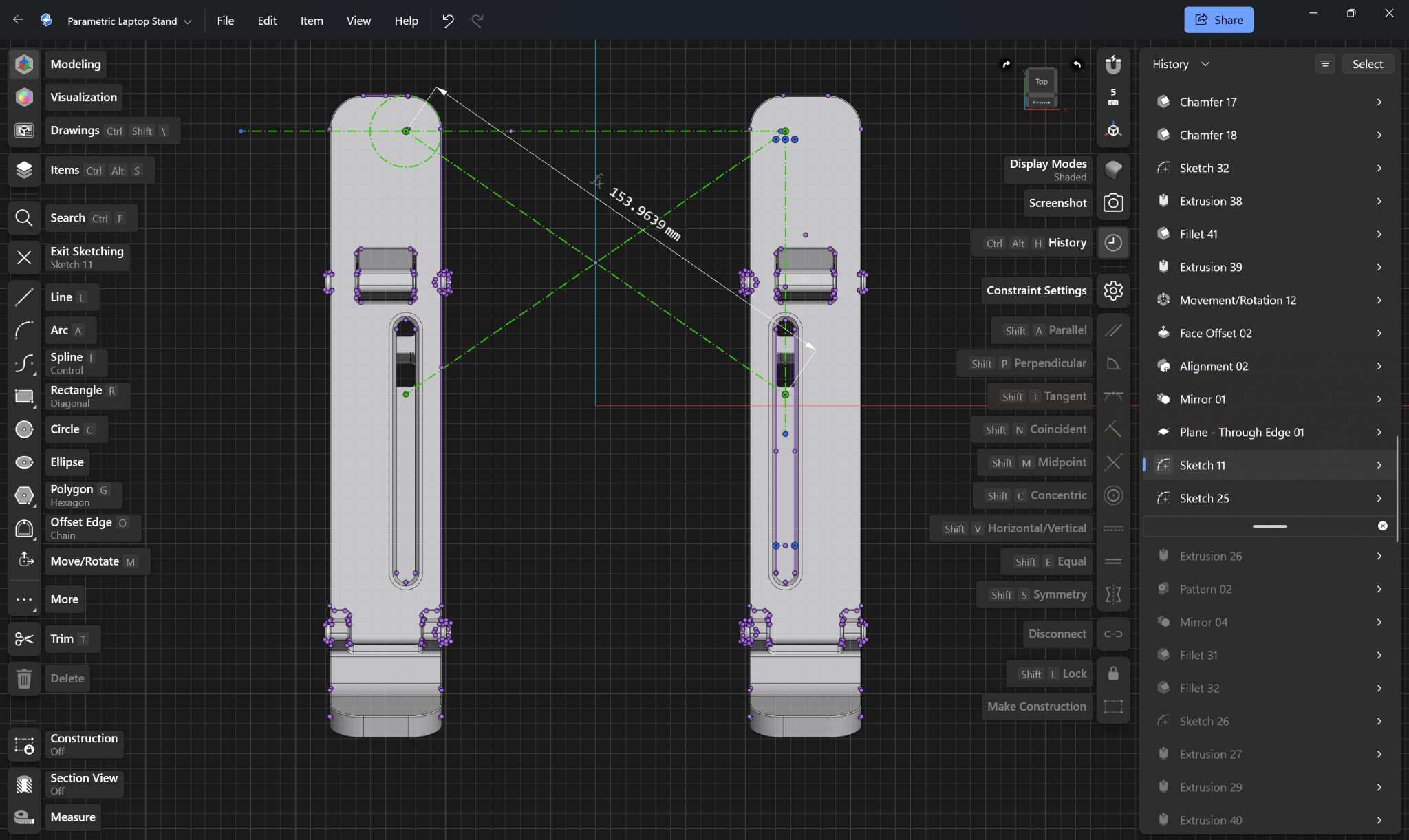

The scissor-style folding mechanism keeps the stand stable side to side and lets it fold flat. Construction lines were drawn to mark the paths where the ends of the arms move (Fig. 14.). The bottom points slide along the slots, while the top points attach near the top of the adjustable bars. To keep the look balanced, a circular reference line was used to place the top pivot points at equal distances from both edges.
Fig. 14. Folding construction lines

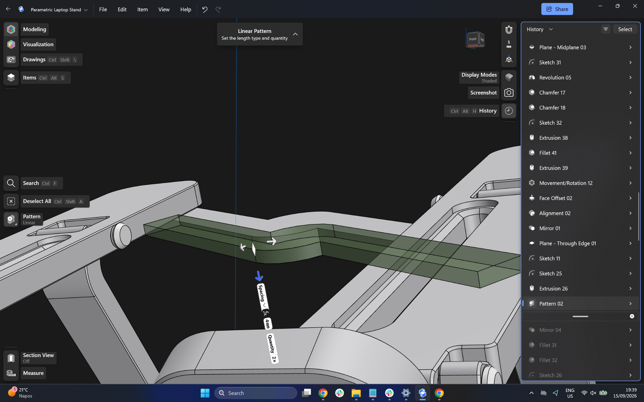

Creating the overlapping folding arms without parts colliding required doing the CAD steps in a specific order. Instead of just moving a copy (which breaks parametric links), we used the pattern tool to copy the first arm over by half the thickness variable (Fig. 15.). That copy was mirrored across the center (Fig. 16.), and its top surface was extruded up by another half-thickness so the tops lined up flat while creating space underneath.
Fig. 15. Copied with Pattern
Fig. 16. Mirrored

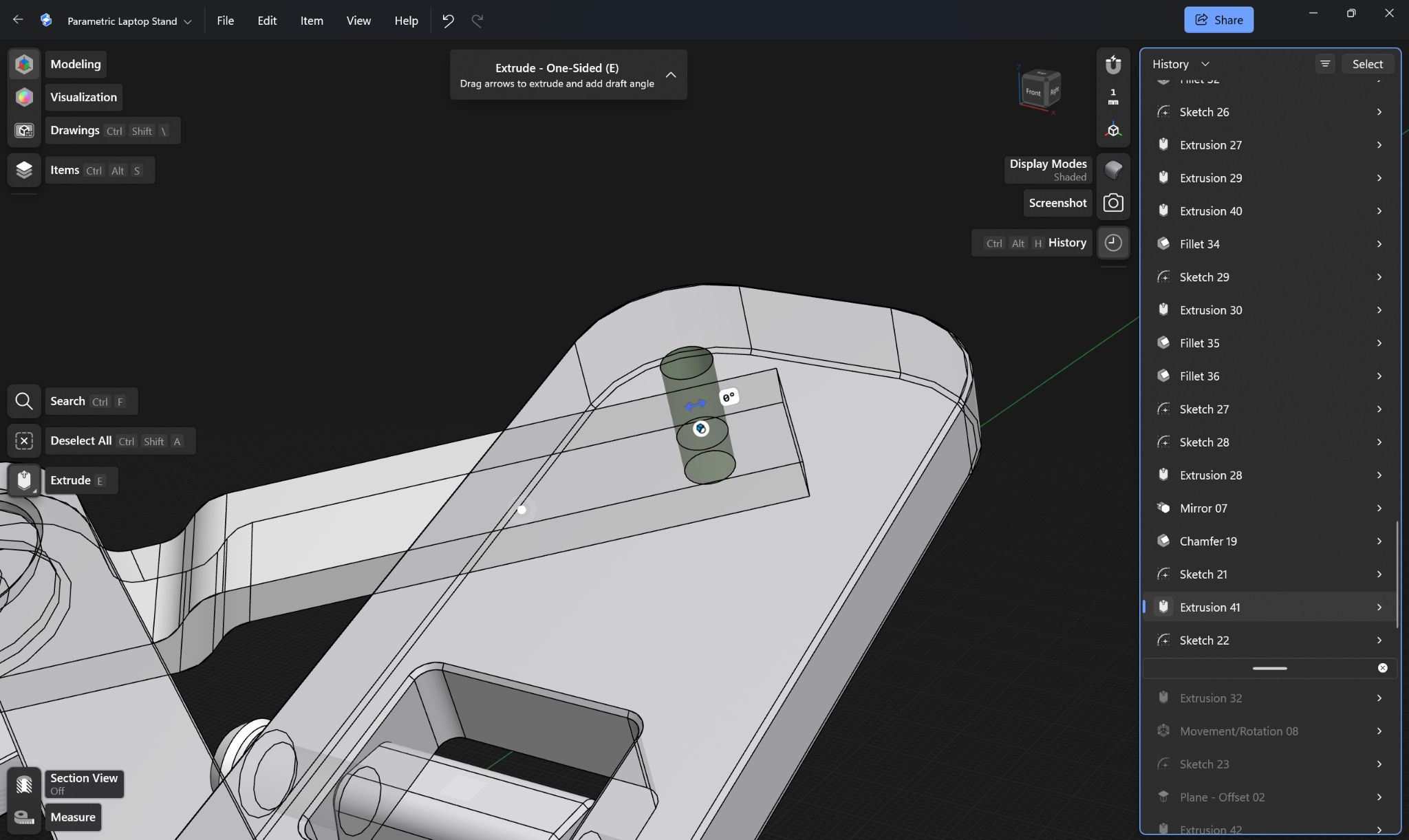

Holes were drawn on the skeleton points and extruded straight through to the other side of the arm. Using Extrude's Extent To Object setting meant the hole depth automatically matched the arm thickness, even if parameters changed (Fig. 17.). Small chamfers were added to the hole edges so the pin heads sit completely flat, leaving a smooth surface for the laptop (Fig. 18.).
Fig. 17. Holes created with Extent to object setting

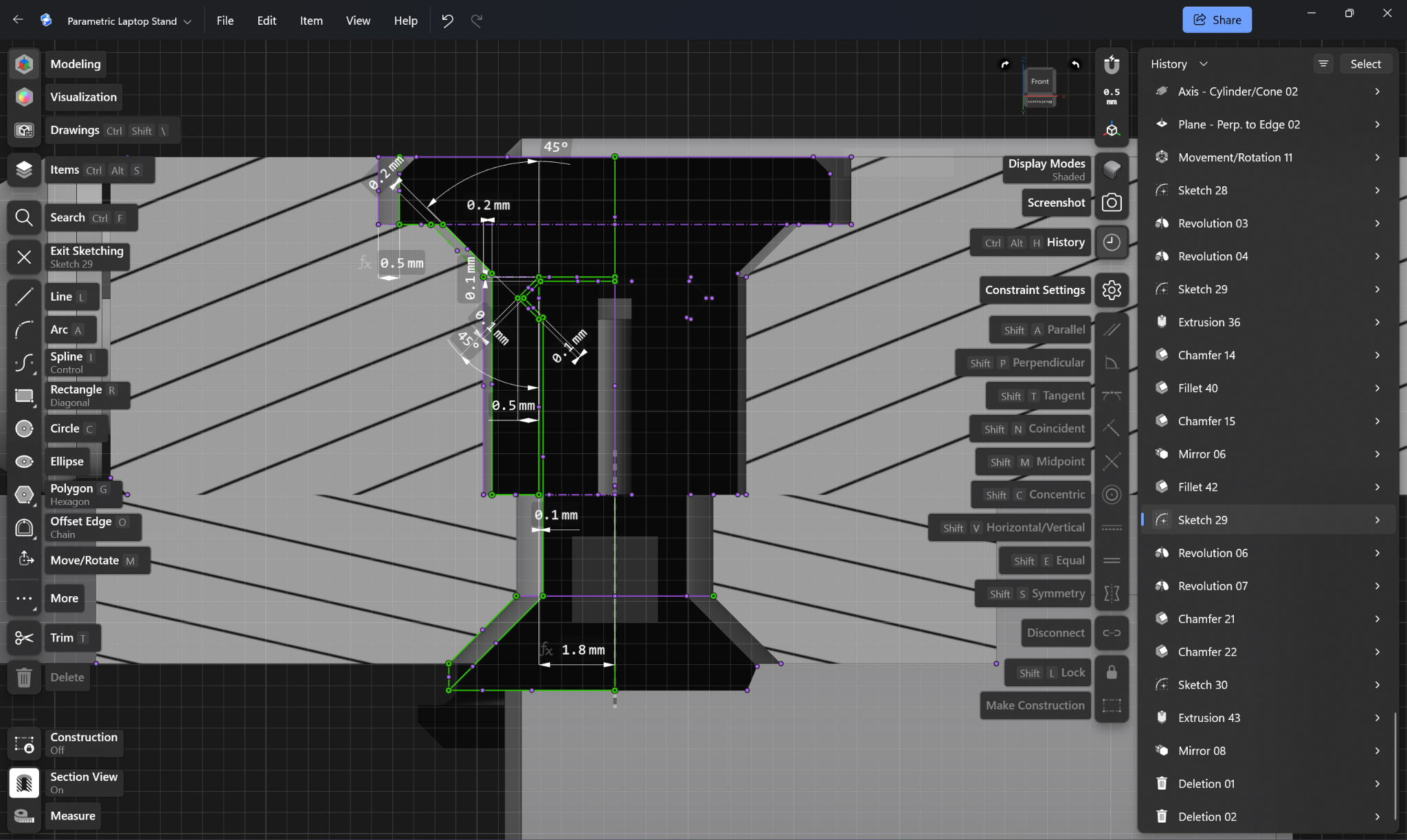

‍Fig. 18. Chamfers added to pin holes for smooth finish

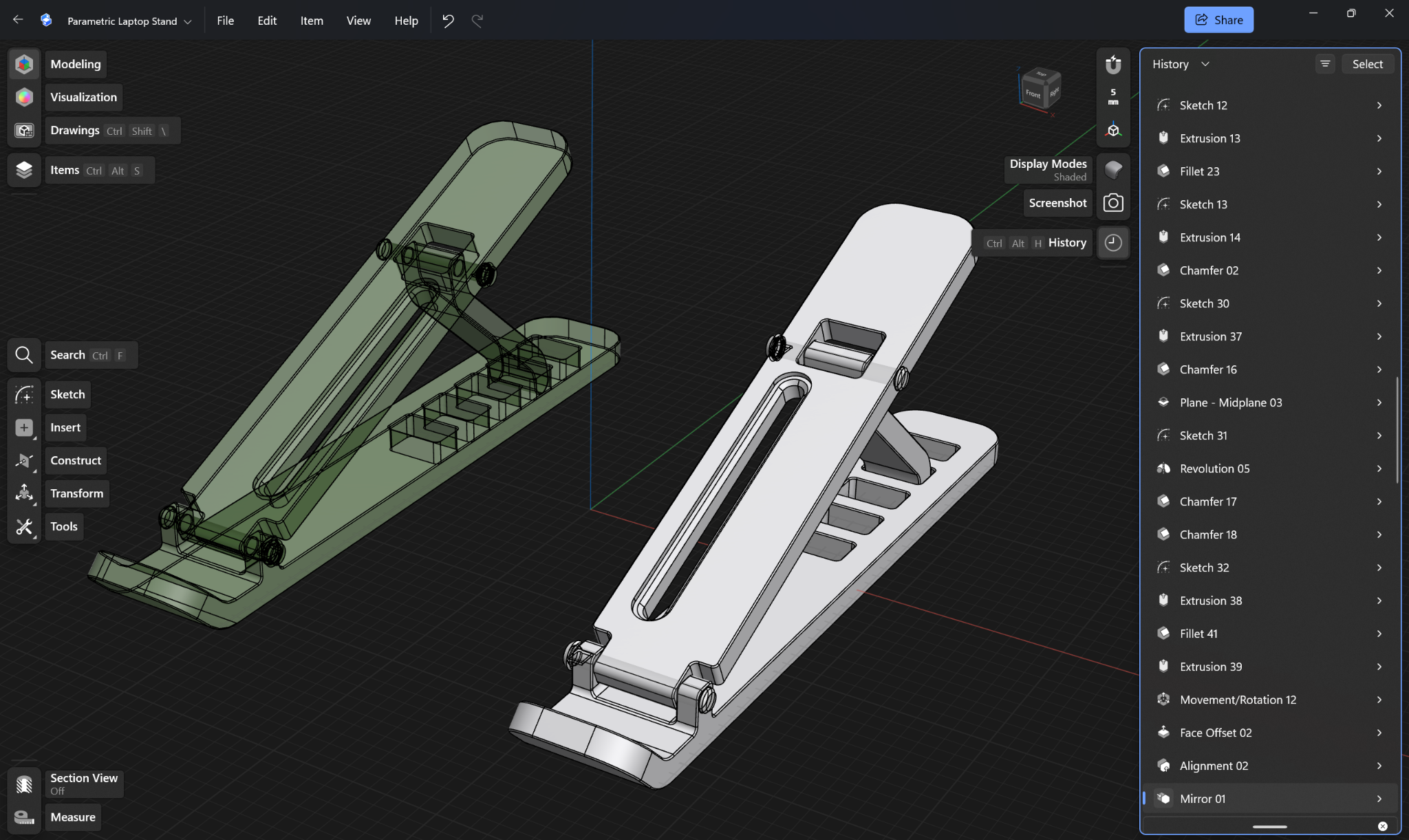

Snap-fit pin variations
The initial model ended with designing the different snap-fit pins for the folding joints, slider points, and top pivots. All pins were made using the Revolve tool around the hole's center line. The male pins got a slightly bigger lip at the end and a cut down the middle to let them bend and snap into place. The pins were drawn on one side and mirrored to finish the initial model (Fig. 19.).
Fig. 19. Male (bottom) and Female Pin design

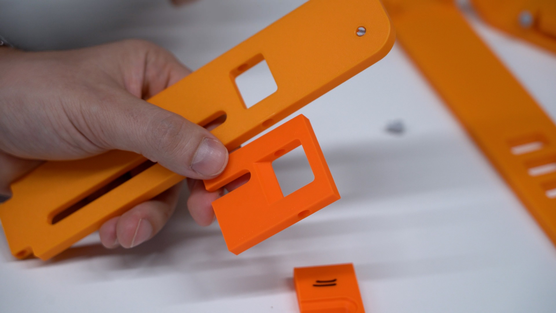

Printing and testing

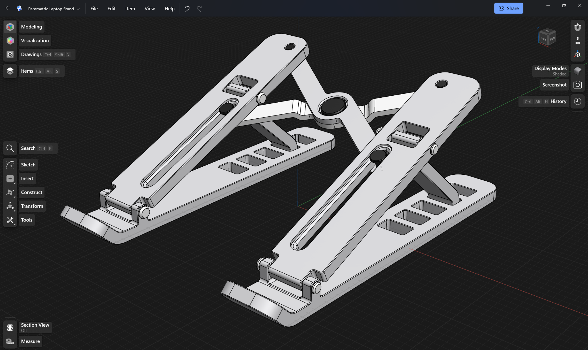

Fig. 20. Finished model

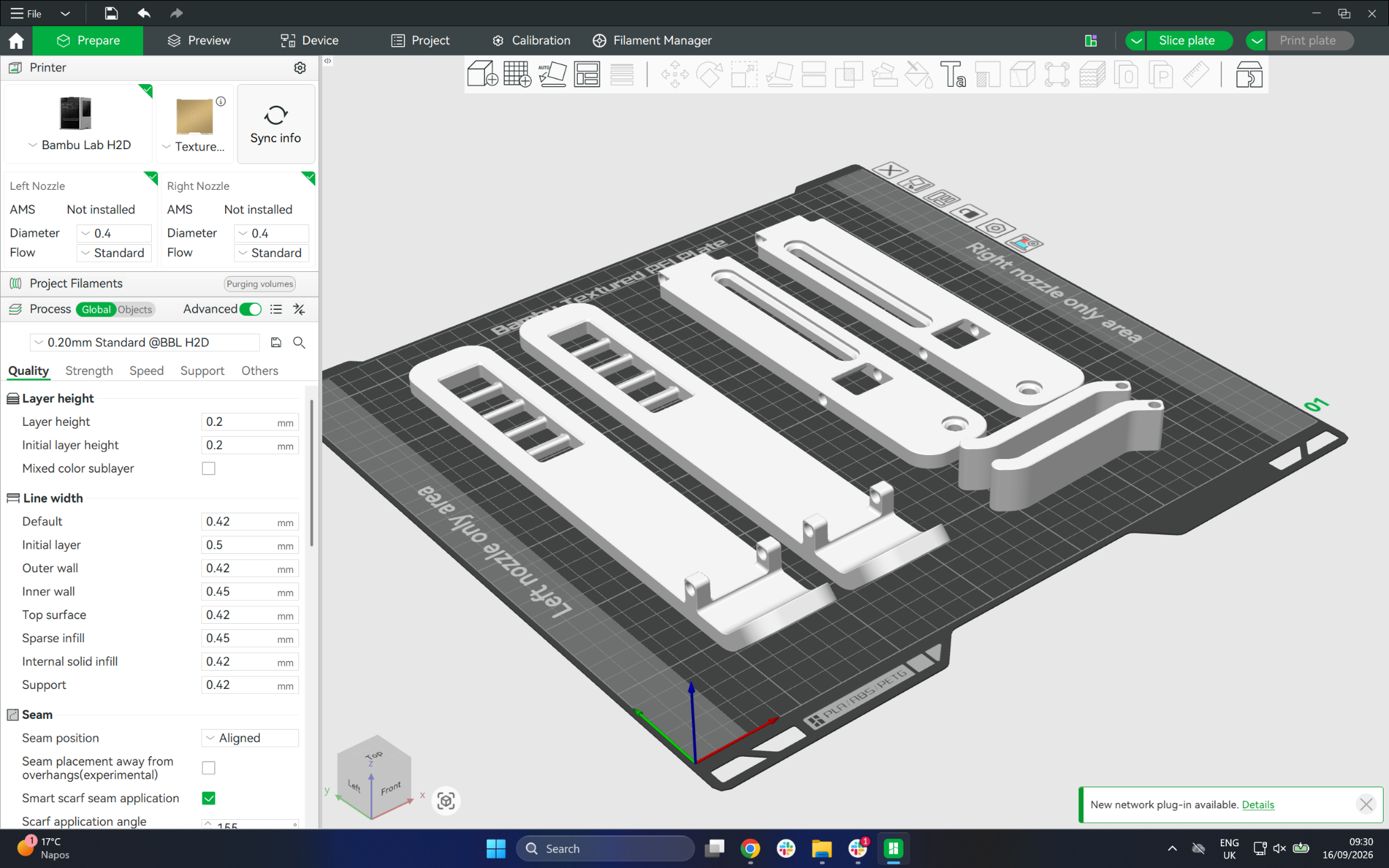

Once the first CAD model was done, we started 3D printing. We used a Bambu Lab printer and a Prusa Core One. The big structural pieces (base bars and adjustable bars) were printed on the Bambu Lab because of its larger print bed. The smaller pins were printed on the Prusa for better detail. Everything was first printed in PLA (Bambu Orange for the body, Prusa Marble Silver for the pins).
The first full print, with all parameters set to their defaults, went together fine. Testing, however, revealed a few real design problems that needed fixing.

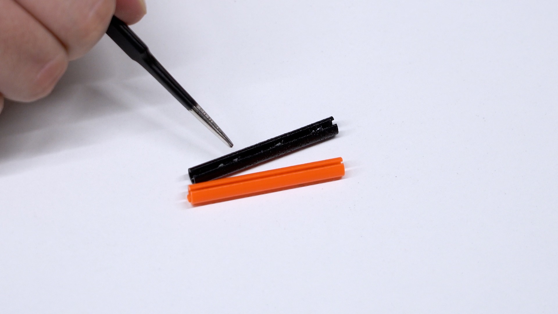

Pin flexibility & material selection

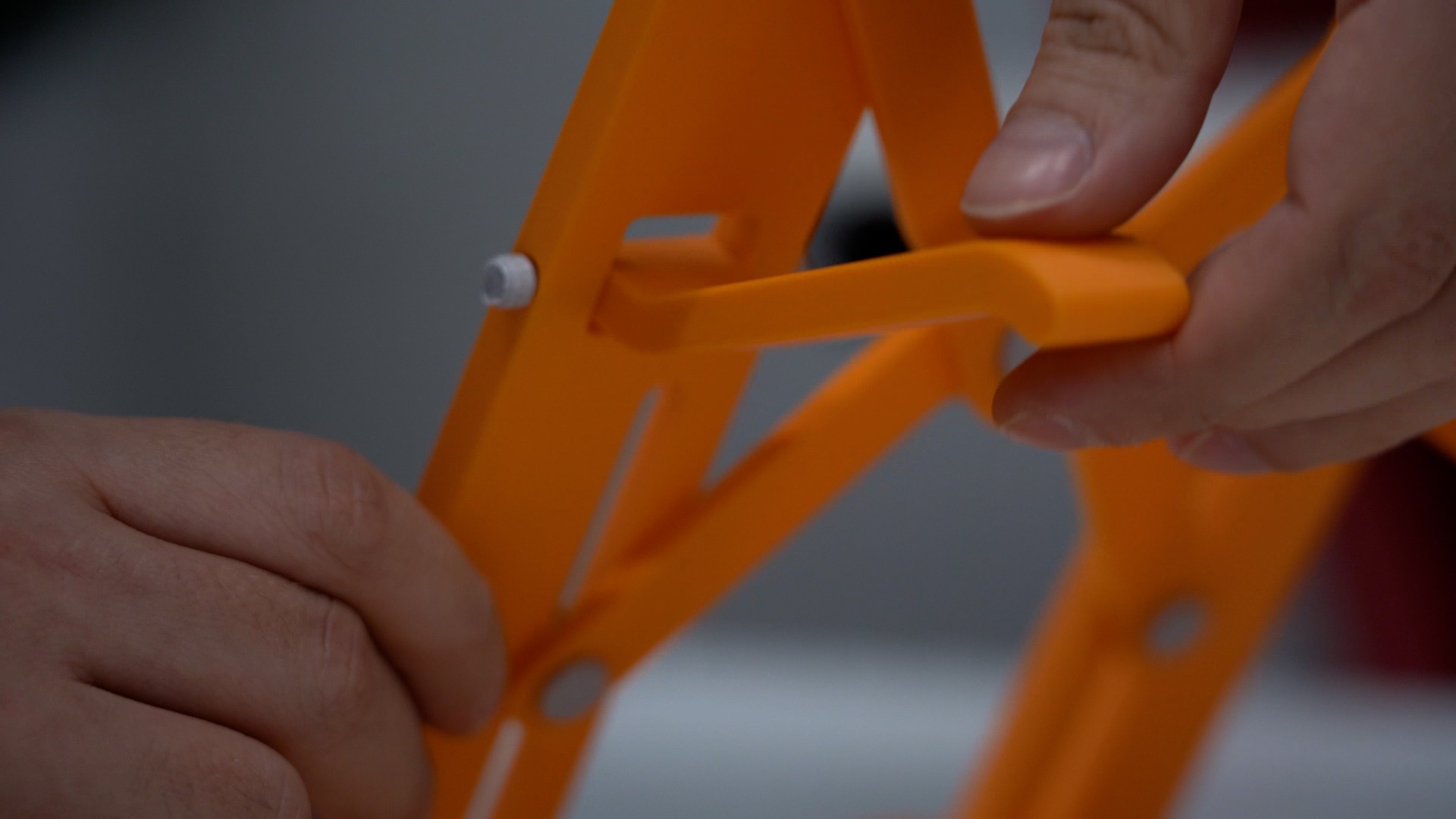

The original 5mm snap-fit pins broke easily during testing. Because the pins were small, the snapping features were less than 1mm thick. This made them weak and prone to snapping along the print layers when pushed into place. We tried different snap designs (cuts in the middle, caps, split cylinders), but none were strong enough in PLA.
To fix this, we redesigned the horizontal pins into simple split sleeves: hollow pins with a slot running down the side. This slot lets the whole pin squeeze down when pushed in and spring back open inside the hole. We also switched the pin material from PLA to black PETG. PETG is tougher and more flexible, stopping the pins from snapping while giving them the springiness needed to click in and out. (Fig. 21.)
Fig. 21. Final pin design, with slot running down the side
For the folding mechanism pins, space was too tight for a normal snap pin. We solved this by making the pin body thicker, widening the slot, and adding a small retention ring on the end. We also made the frame holes slightly bigger for these stronger PETG pins.

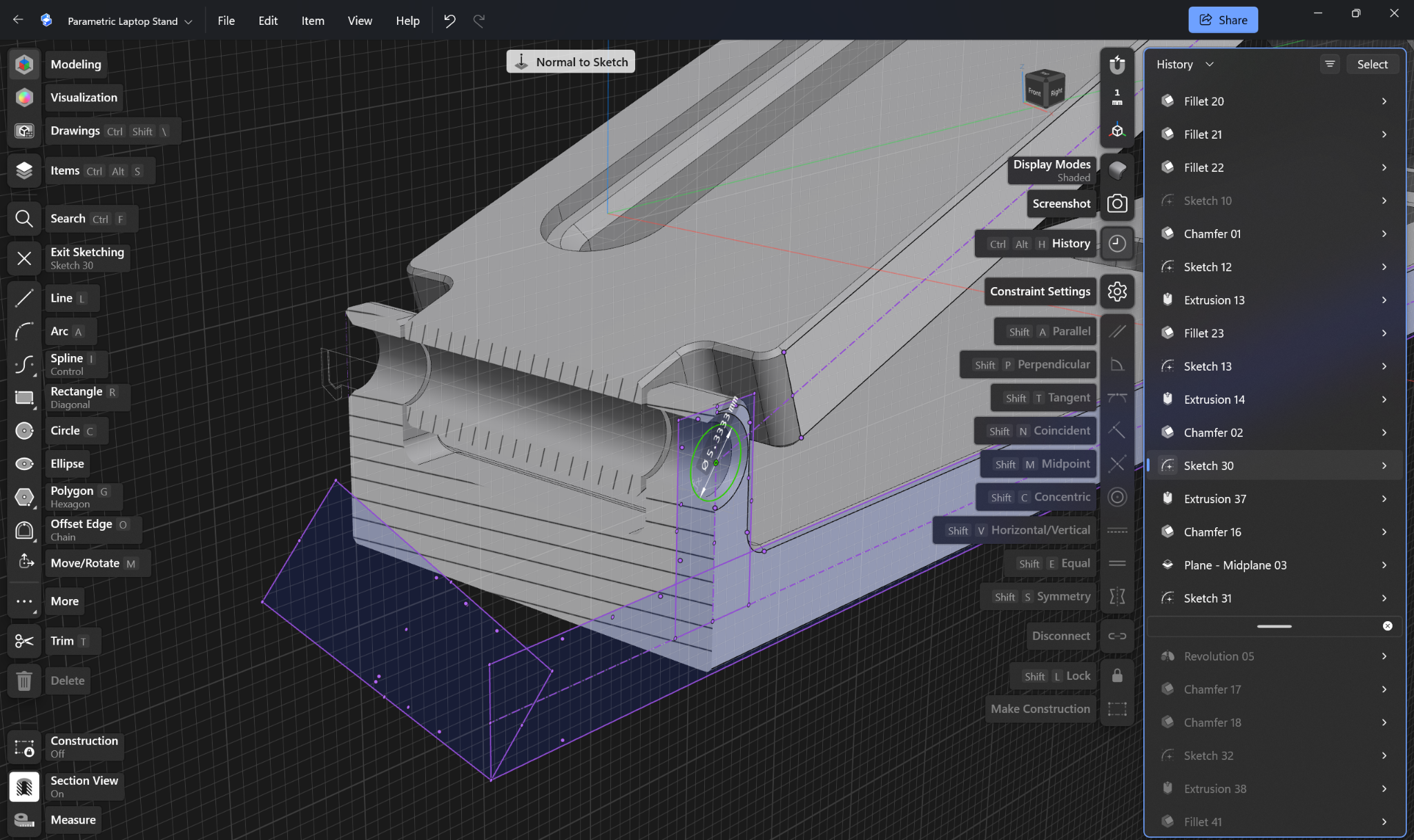

Vertical support range of motion

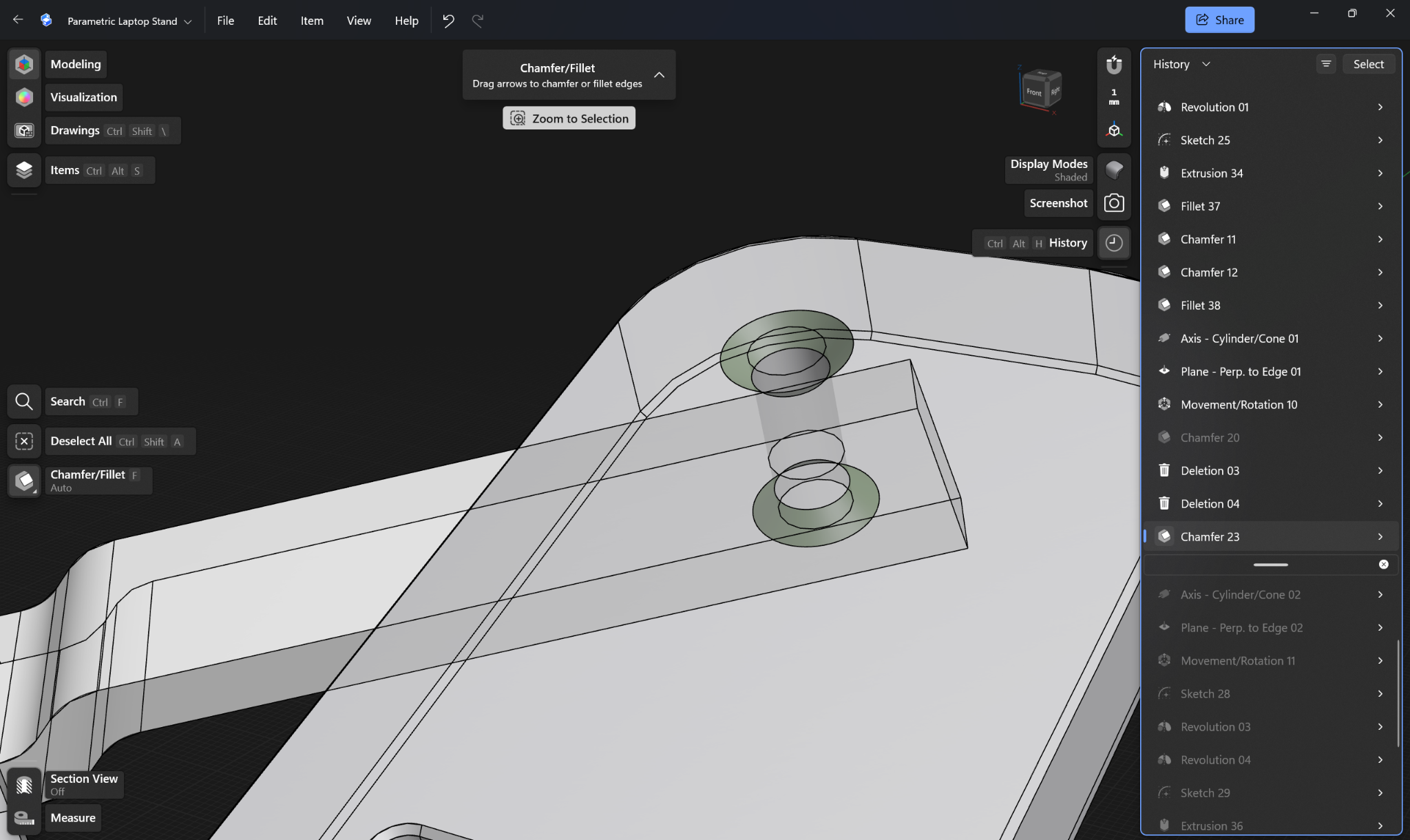

Because of how the vertical supports rotated around their pivot point, they were stuck at less than 90 degrees of rotation instead of moving freely up to 180 degrees. This meant the supports couldn't reach the two lowest angle notches on the base bar.(Fig. 22.)
Fig. 22. The notch didn't allow for adequate range of motion
The fix was easy: we added a bevel (chamfer) to the edge of the hole. This gave the support arm extra clearance to swing further, letting the riser use every single angle notch. (Fig. 23.)
Fig. 23. Added bevel to allow for more motion

Clearance calibration & rapid tolerance testing
The biggest issue with the first test print was that all the joints were too loose. Small gaps between pins, slots, and hinges added up, making the whole stand feel wobbly and cheap. To fix the clearances without wasting time and filament on full prints, we cut out small test pieces of just the joints.
We printed and tested small test chips in 0.05mm steps for four main joints: pivot hinges, support arm joints, notch fits, and slider pins. Testing these small parts let us find the exact right clearance for every joint, snug enough to stop wobble but smooth enough to move easily. We then fed these exact measurements back into the full model.

Main parts
Printer: Bambu Lab H2D
Slicer: Bambu Studio
Print time: 7 hours 41 minutes
Material: PLA
All default settings, except:
Variable layers turned ON
  • Variable layer height was used to improve the print quality of the base bars, particularly around the holes, angled surfaces, and curved geometries, while maintaining thicker layers in less complex areas to reduce printing time.
Quality settings > Ironing type: Top surfaces
  • Makes the flat top parts, where the laptop sits look totally smooth instead of layered.
Quality settings > Wall generator: Arachne
  • Fills in tiny gaps automatically so the print doesn't have weak hollow spots inside.
Strength settings > Wall loops: 4
  • Makes the outer walls thick so the stand feels heavy, solid, and doesn't bend.
Strength settings > Top shell layers: 6
  • Puts a thick lid over the inside grid so the top stays completely flat without sagging.
Strength settings > Bottom shell layers: 4
  • Gives the stand a flat, sturdy base so it doesn't warp or tip over.
Strength settings > Sparse infill pattern: Gyroid
  • Stops the nozzle from hitting itself while printing fast, making it strong in every direction.
Speed settings > Outer wall: 150mm/s
  • Slows down the outside layer just enough to keep the plastic shiny, smooth, and free of weird bumps.
Speed settings > Inner wall: 200mm/s
  • Saves time on the inside layers where nobody can see them anyway.

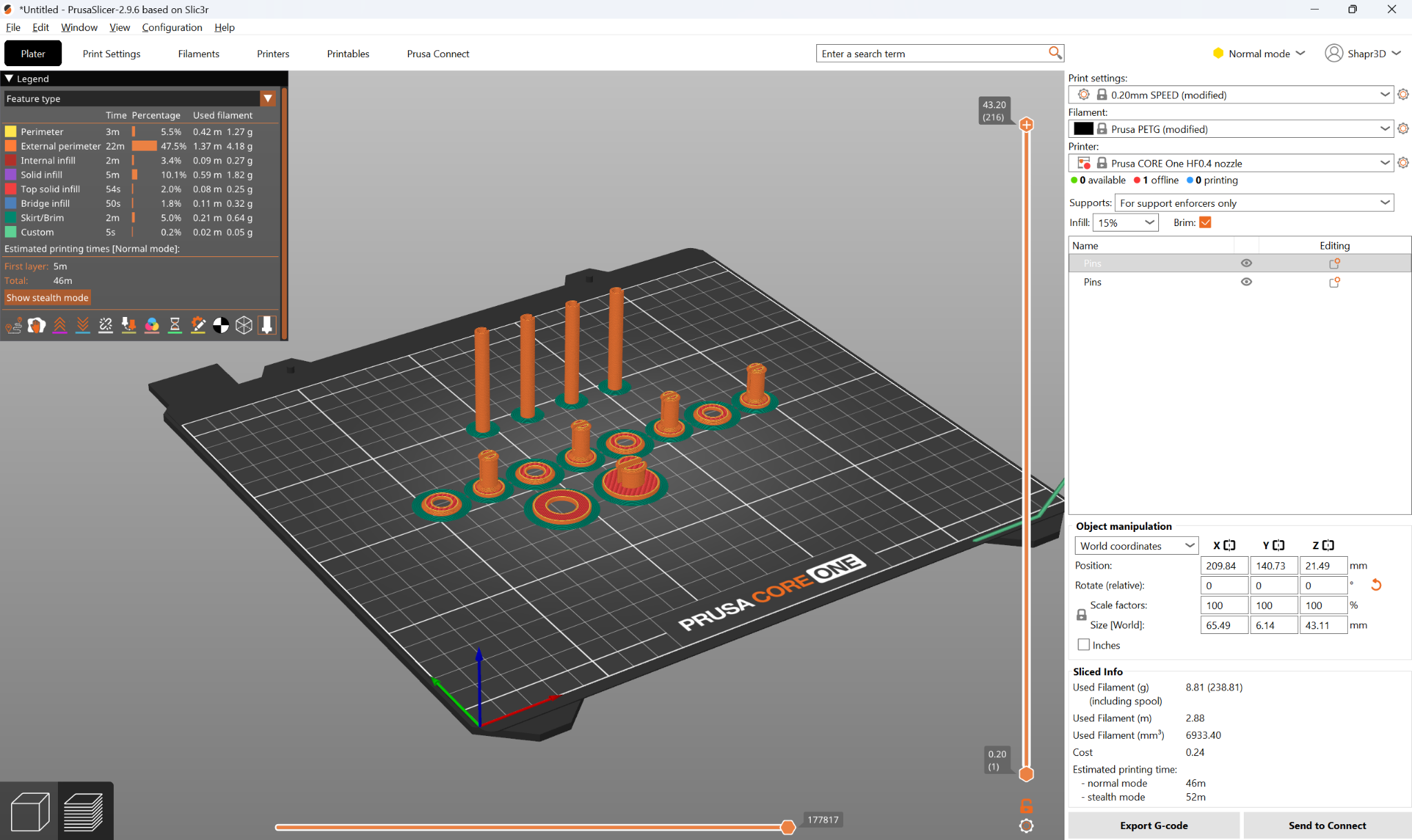

Pins
Printer: Prusa core one+
Slicer: PrusaSlicer
Print time: 46 minutes
Material: PETG
All default print settings, except:
Skirt and brim > Brim width: 4mm
  • Brims are off by default. Adding a 4 mm brim expands the footprint of tall or small parts, giving them enough bed adhesion to stay glued down and stable throughout the print.

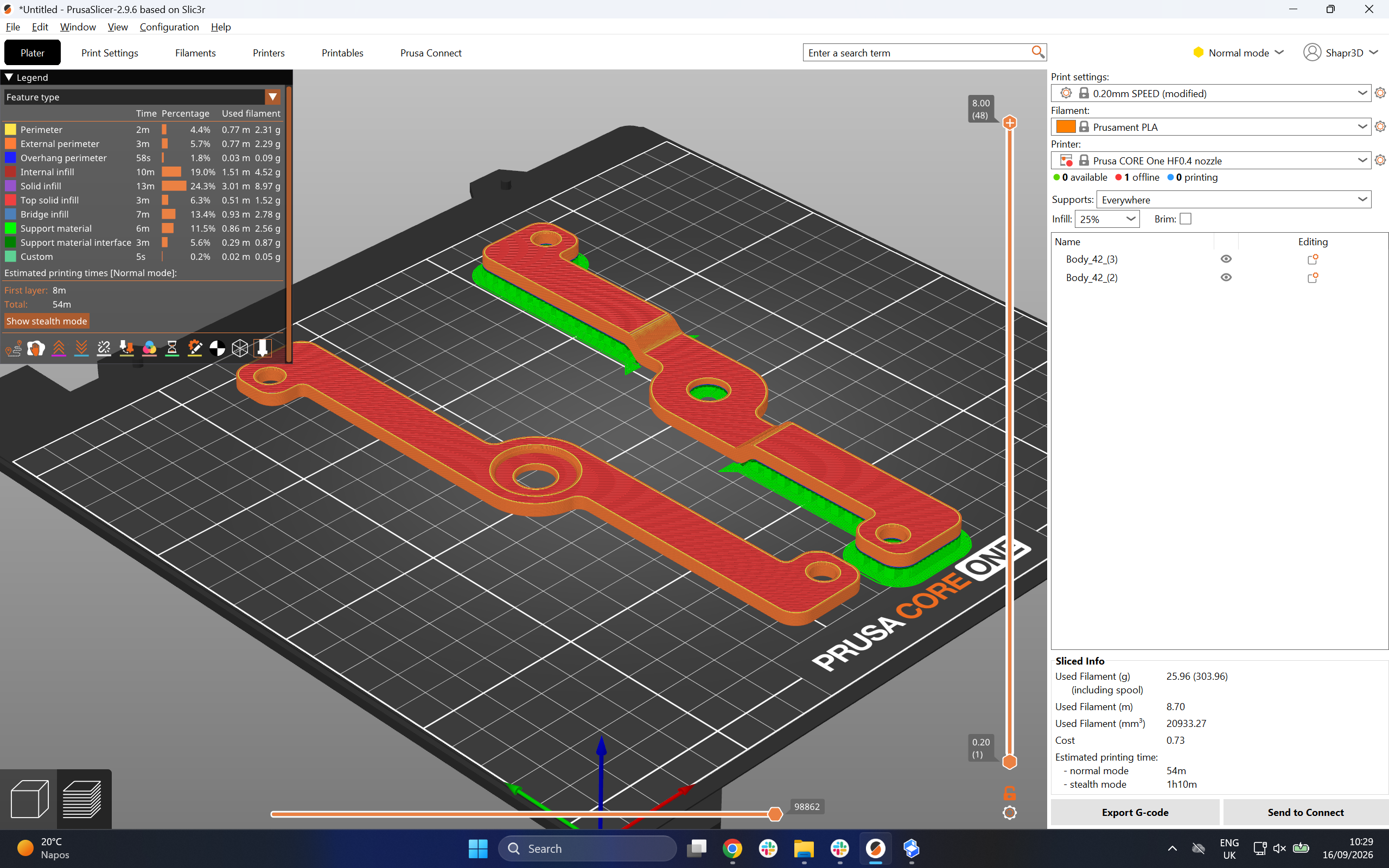

Folding mechanism
Slicer: PrusaSlicer
Print time: 7
Material: PLA
Support material > Auto generated support: ON
  • Supports are off by default. Turning on Auto Generated Support lets the slicer automatically place support structures under steep overhangs so complex parts don't collapse while printing.
Support material > Top interface layers: 2 (default)
  • The default of 3 layers creates a heavy barrier that fuses tightly to the part. Lowering it to 2 layers makes the supports much easier to break away cleanly without leaving rough marks.
