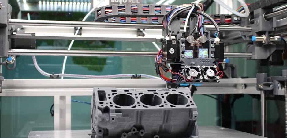

Rapid prototyping is a process of building parts by adding layers of material that has existed since the 1980s. In more recent decades the methods used have expanded rapidly due to developments in CAD, inexpensive robotics, and materials.
What is Rapid prototyping?
Rapid prototyping comprises a set of processes that progressively build parts by laying down thin layers of material. The material can be fused in a number of ways, including powder or liquid fused by UV light or laser, melted plastic filament extruded in layers like toothpaste, or sprayed like ink from an inkjet printer. The materials used can also vary widely from soft elastomers, semi-rigid plastics to resin infused with fibers or powdered metal.
The attraction of rapid prototype processes is that you can make just about anything without making expensive and long lead time specialized tooling. For example, you can make plastic parts without making injection molding tooling first. This is an obvious save of time and money. Plus,
you can make the rapid prototype parts directly from CAD data without the need for specialized CNC software and machining experience.
Because you can skip steps in the usual manufacturing processes and produce a low number of parts quickly, and product development teams could create multiple iterations more quickly, these processes at first were used almost exclusively as prototyping processes. The name Rapid prototyping stuck for a couple of decades until more sophisticated materials, machines and processes were developed which enabled these parts to be used for more than just prototyping.
The term 3D print has actually stuck for a long time, even though it originated from the ink jet connection between 2D printers and some models of 3D printers. It is a catchy name but it doesn’t really represent the genre as a whole.
Over time, it became more obvious that the notion that the processes all had in common was that they built parts by adding material rather than cutting away material. Gradually, these processes have become known to the industry under the more broad header of Additive processes.
The materials are usually a plastic blend, but they can take on a number of properties. You can also get more exotic and expensive materials such as metallic blends, fibrous materials such as glass, carbon, and wood products. There have also been developments in printing food materials for decorative shapes, concrete for large scale construction, and biological materials for organ replacement.
Traditional manufacturing methods impose limitations on your products.
Sometimes these limitations are based on easily fabricated shapes, such as I-beams, sheet metal, or wire. Sometimes you are limited to shapes that can be molded inexpensively due to limitations in mold tooling. Additive processes remove many of these limitations and allow you to design without worrying so much about the limitations of traditional manufacturing methods.
primer plano del cabezal de impresión añadiendo más capas de filamento a la hélice - 3d print fotografías e imágenes de stock
