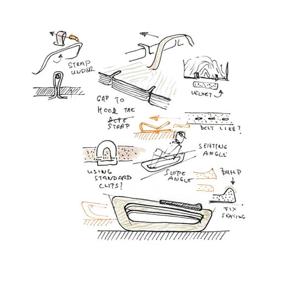

I began work with the ideation process. The aim of this phase is to come up with a bunch of raw ideas that can be used for detailed development later on. Usually, ideation involves brainstorming designs, structures and mechanisms, or creating moodboards and researching materials.
At this point in the process, I never limit myself. Everything that comes to mind gets recorded, no matter how extreme or innovative.
Classic Paper and Pen Sketch Notes
For this particular project I skipped traditional “brainstorming.” Instead, I focused on researching how to work with and apply bent wood as a material. Using the challenge description as my brief, I quickly generated holistic and detailed sketches.

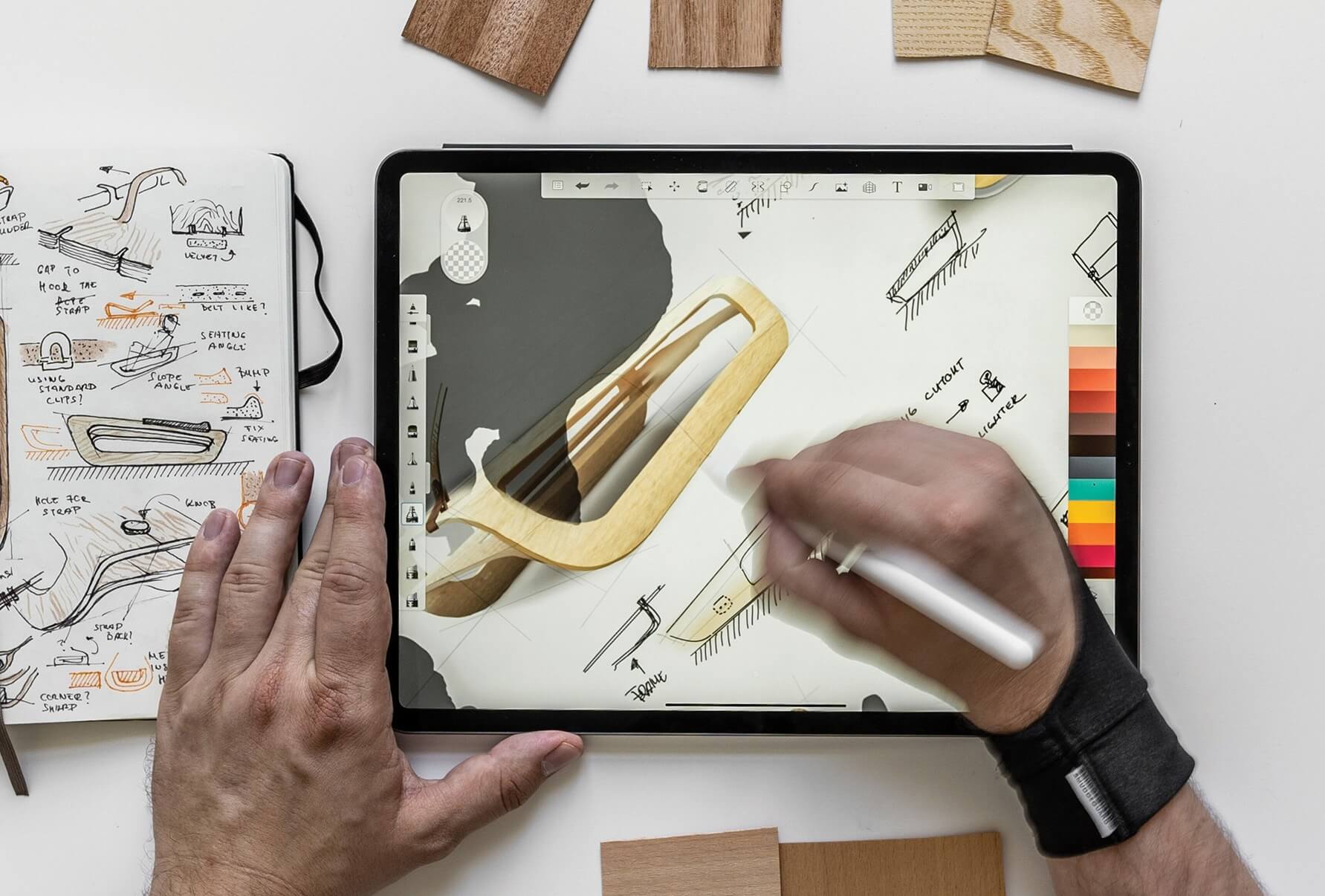

Pencil and paper sketches are perfect for quick idea notes. Digital sketches are ideal for detailed development and also to present to potential consumers.
I used my sketches to validate my ideas and collect feedback on Instagram. This way I was able to test basic assumptions with potential end users.
Detailed Designs on an iPad

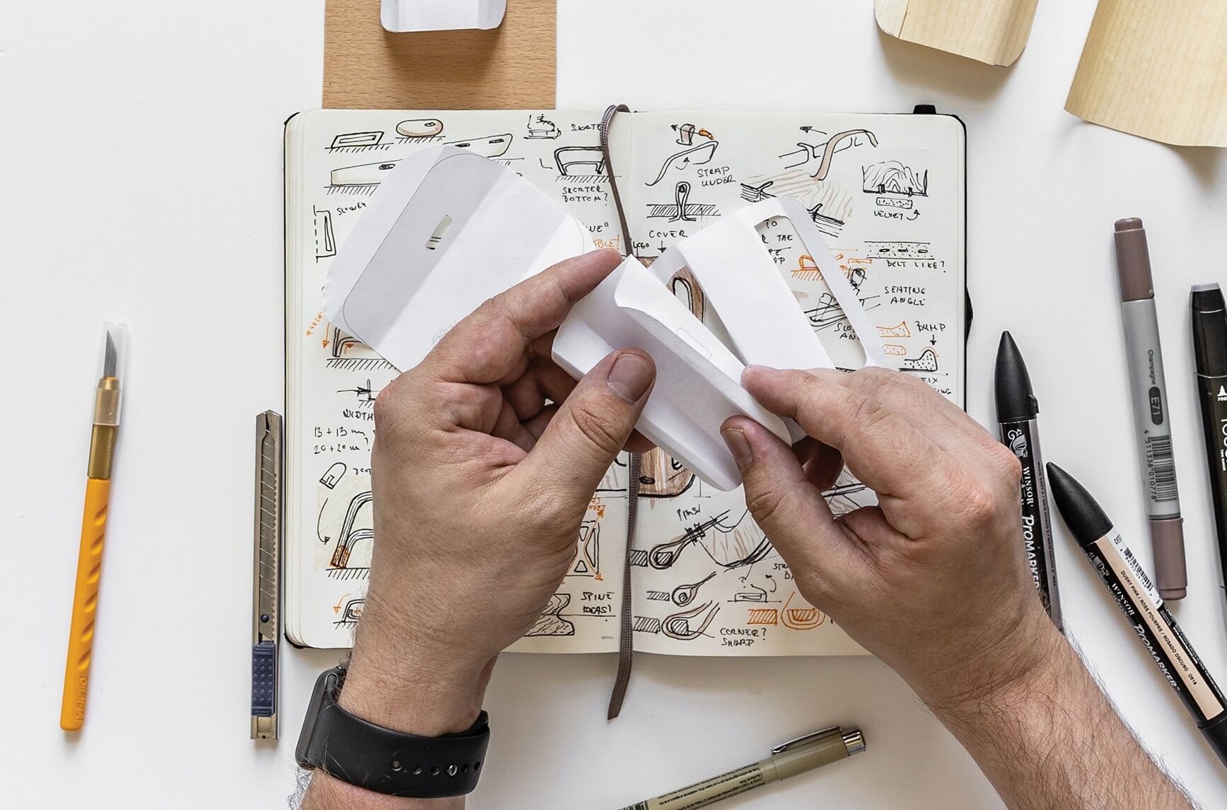

In addition to drawing concepts, I also created rapid mockups with paper to test some of the ideas in 3D. I chose paper because it is cheap, fast and simulates the qualities of pliable wood quite closely.
Bent plywood technology determined the form language of the project and I quickly went to simple paper proto types to get a couple of raw, working concepts. After identifying the most promising details I began work on the sled’s form language and product identity.
This is the easiest way to get instant 3D feedback. Use cardboard and colored paper to immediately get a feel for the CMF process later on.

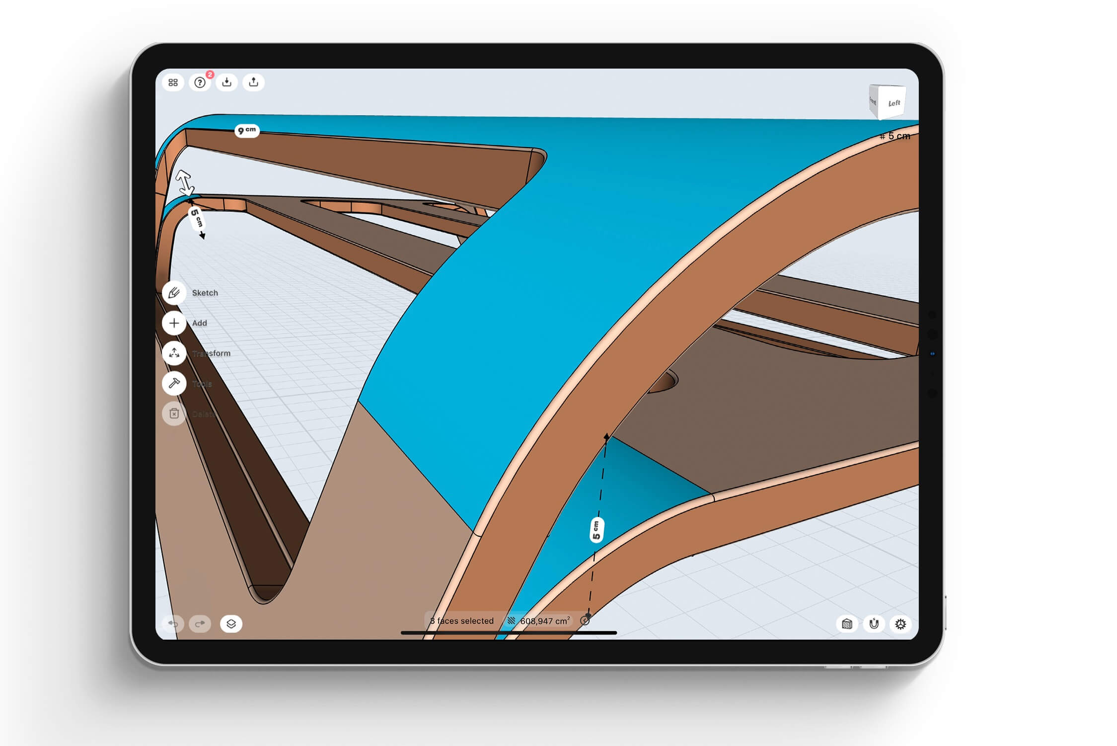

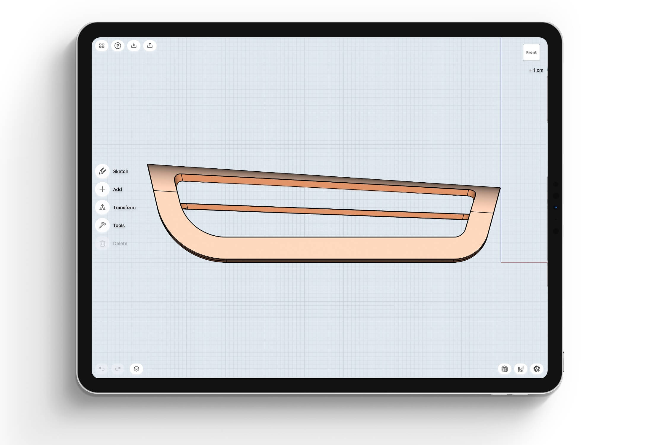

3D design prototypes

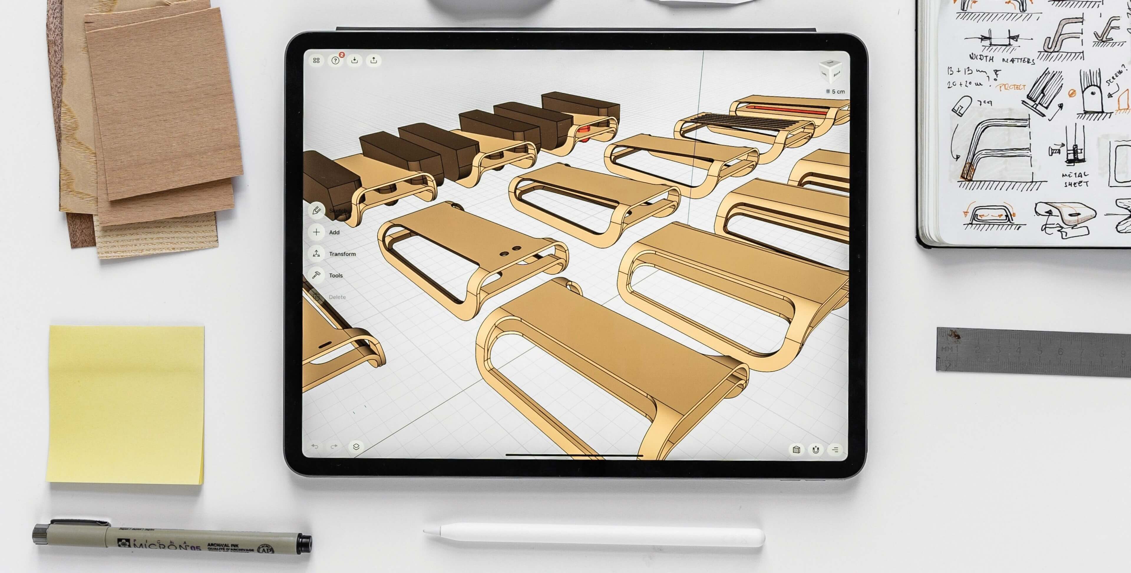

Next, I visualized the strongest ideas in CAD to validate structural details. Using this method, I could validate things like radius values, material thickness and the structure’s general proportions.
3D mockups are great for coming up with an infinite number of iterations, then checking and comparing them from different angles to inform decision making.
From the get go, I decided to center Slē’s identity around bent plywood structures. This type of wood has a smooth surface and an accurate, even thickness. It also comprises the high impact resistance necessary to withstand outdoor conditions. Material selected, there were a couple of key structural elements that remained to be tested.
3D Design Prototypes
incline grades up to 25%
The tilted seat and frame were specifically designed for the slopes, providing a convenient seat and maneuverability on incline grades up to 25%.
self-supporting arches
The radius of the upper and lower arches are designed to be both self-supporting structures and iconic design elements.
The “double arch” construction of the Slē was designed based on physical properties that made it durable enough to withstand recurring forces while sledding.
Method 4.
3D printing
The best iterations can be 3D printed to provide the client with an actual model for consideration.
I exported an .stl file from my project in Shapr3D and printed a few scaled models with the proper dimensions, thickness and geometry. While I’m validating, revising and making adjustments to the 3D printed versions of my models, I will create a few dozen to over 100 versions.
3D prototypes can be printed quickly and are ideal for checking ratios and dimensions, even on a smaller scale. This process is also usually iterative — the low cost and speed let you print several models, make adjustments and print more.

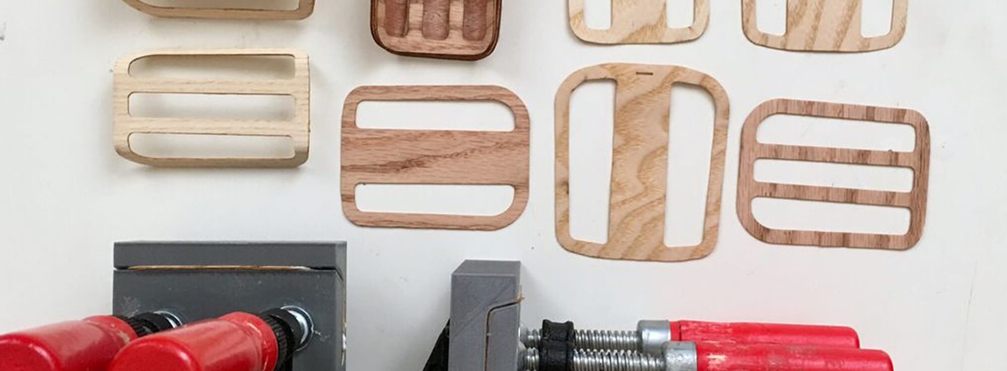

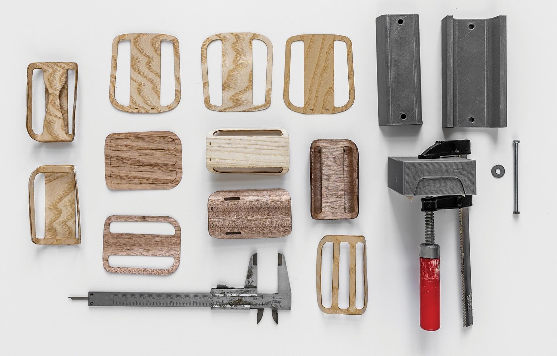

Molded veneer model
Another method, equally useful and a bit more elegant is to create a 3D printed mould and recreate the mockups using veneers. This method makes it easier to define manufacturing properties and make cor rections in the CAD model.
I laser-cut the outline of the sled onto veneer sheets and bent them into shape using a 3D printed jig. Due to the scale of the mockup I only used 2-3 layers of veneer for each element. The process was repeated with several types of veneer, which also helped me validate any lingering CMF questions.
This step allows you to look at weaknesses in the design, and also doubles as an elegant mockup for presentations.

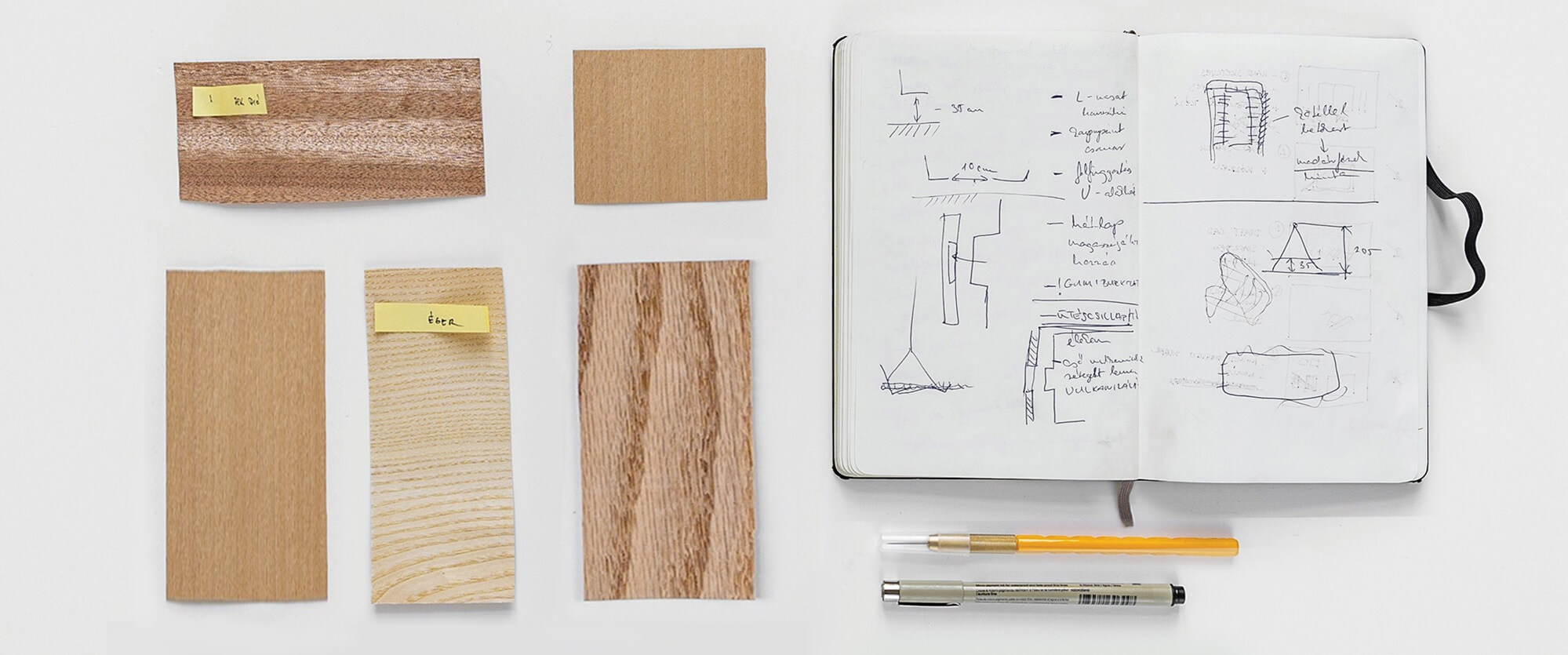

Color, material, finish (CMF)
CMF is an important part of the material selection and the upcoming manufacturing process. During the CMF (Color, Material and Finish) design phase I tested 5 common plywood veneers. Each selection was ranked based on their physical properties, aesthetics, local sourcing and costs. I finally settled on Beech plywood.
Beech plywood is a hardwood plywood that’s incredibly strong yet still flexible, with a high resistance to creep and impact. Beech is commonly used for sports gear and furniture, and its color and texture are warm and friendly. Once I decided to use Beech, I tested its resistance against harsh environmental factors like ice and water immersion, and whether it was durable enough for an activity like sledding. I also checked the viability of Beech with manufacturers.
